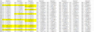

1、After the SPI communication is normal, the register of ADS is configured as follows:CONFIG1=0x92, CONFIG2=0xE0, CONFIG3=0xC0, FAULT=0x00, CHnSET=0x10(n=1-8);
2、Then, EVM is used to measure the output of linear power supply (its output voltage is 1.778V measured by multimeter), and EVM channels 1, 2 and 3 are used to measure, and the other channels are not connected.
      After measurement and conversion, it is found that sometimes the measurement data is wrong, may I ask what may cause this?

  • Hi Ryan
    Thank you for your reply.
    I use TMS320C6678 to control ADS131E08EVM to obtain data. I've successfully read and configured the registers before. After code conversion, the data is displayed on the CCS console. And then I put the results in Excel, and then you see the picture.

  • Hello Zhen,
    My suggestion would be to analyze the SPI communication using a logic analyzer. Specifically, you will need to capture DRDYn as well as CSn, SCLK, and DOUT. It's possible that the SPI frames are overlapping the next DRDYn interrupt, causing the channel data to be overwritten with new data. On the ADS131E08, each new conversion result is preceeded by a 24-bit STATUS word, which always begins with 0xC0 in the MSByte.
