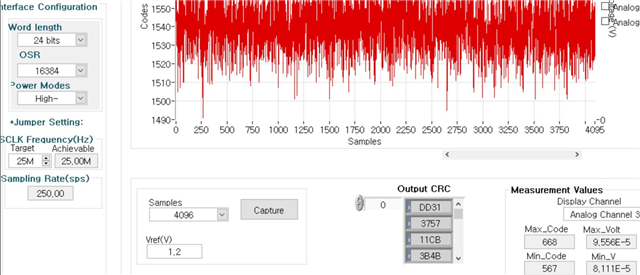

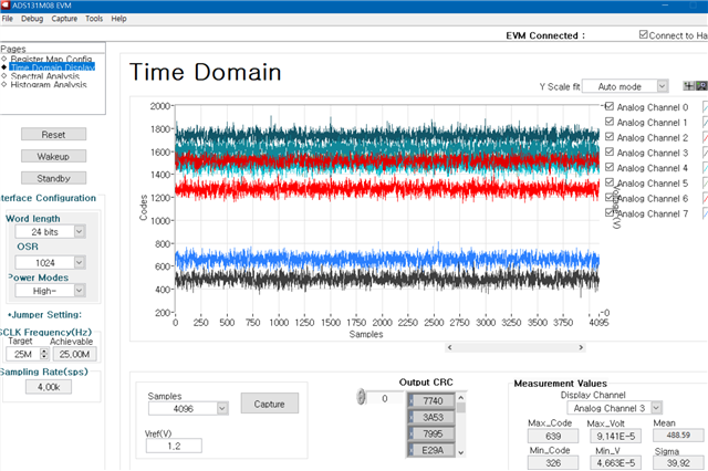

1. In ADS131M08EVM, the setting value is default, and the input of the channel is connected to GND.
    A voltage of 50 uV appears on three channels. What is the reason?
2. When a voltage of less than 1mV is applied to evm with cal equipment, 0V is displayed. Is it not possible to measure less than 1mV?

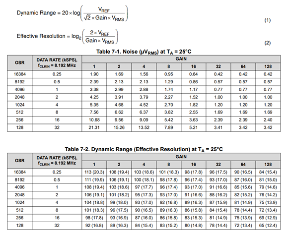

3. ads13108 is 24bit and the resolution is 71nV. However, uV cannot be measured. What is the reason?
4. What is the lowest measure?
