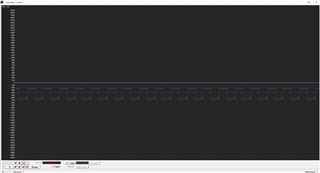

  • Thanks for your help. Now, Test signal coming without noise and also able to get ECG data from ECG-simulator. But now whenever I am trying to increase sample-rate by changing CONFIG1 register value to "0x04", I am not getting proper signal, and I don't know why.
    ADS1198 Settings for Channel reading:

    could you show the difference of the results between setting CONFIG1 Bits[2:0] to
    110 fMOD/1024 125SPS
    100 (default) fMOD/256 500SPS
    Is your fCLK = 2.048MHz?
    Do you use your own MCU? Does your MCU program also adapt the data rate change?
    Could you try the internal test signal again or inject some known signals/voltage?
  • I configured fCLK = 2.048 MHz and using own MCU ESP32. I am sharing the result of internal test signal with you. So, you can understand the problem that I am getting. In the below picture Sample rate = 500 SPS:
    Note: CONFIG1 = 0x04 and other setting are the same that I shared earlier.
    Result: At 500 SPS (with internal test signal)
    Result: At 125 SPS (with internal test signal) (CONFIG1 = 0x06 and other setting are the same that I shared earlier.)
    Thanks for the pictures.
    Have you tried different data rate? or does this only occur when the data rate is set to 100 (default) fMOD/256 500SPS?
    Does your MCU program e.g. timing and/or data array and/or memory allocating also adapt the data rate change?
    I suggest to probe the SPI signals lines and do side by side comparison between the two different data rates to see whether there are any glitches or jittering occurs along the SPI signals lines.
    And please make sure the SPI signals match the timing constraints in the datasheet.
