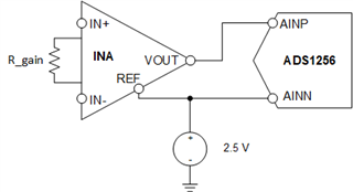

i am using ADS1256 to read the pressure sensor data and here my ADC is working fine with 0-5V pot. now i wanted to test with the pressure sensor in differential inputs but i need to map the maximum voltage to 104.32mV only so before its 0-5V and i need to map this to 0-104.32mV so for that in the firmware side i changed the ref voltage to 0.05321 V =104.32/2*1000 with this calculation but i couldn't get proper raw counts for this like
for example 0-5V its 0-8388607 and i want same for 0-104.32mV but when i input 0.1V i mean 100mV  its giving  only 1962161 only so how can i map both raw count and final output voltage.??
please help me to resolve this .

  • Another option would be to use an external gain stage that has a gain of 50, which will give you an FSR of 2*±2.5/50 = ±100mV. If you choose this option, you might consider adding some headroom to your system in case your input signal exceeds 100mV.

    Ok. actually i will explain the exact application may be that would be the easy thing for you to give solution. in my project i want read the data of differential pressure sensor and pressure sensor since i have used differential channel reading for differential pressure sensor A0 & A1. and two pressure sensor as a single ended so for differential its varying from 0-8388607 for positive full scale and negative its like -8388608 to 0 .and its working fine but i need raw count for single ended is 0-16777215 is that possible .??
  • Hi sagar m,
    Yes, you would need to design an external amplifier stage with your desired gain. A basic device would be something like an INA333, which is an instrumentation amplifier (you can also build an instrumentation amplifier using discrete amplifiers). Texas Instruments has many other amplifiers to choose from, so I would recommend looking through the available devices at TI.com to find one that meets your requirements.
    The INA output is usually pseudo-differential. In other words, the voltage on the VOUT pin is referenced to the REF pin. The voltage on the REF pin can be referenced to ground or to some other voltage. In your case, I would recommend 2.5V assuming you will not be using the ADS1256 internal buffer. The connection diagram would look something like the image I have drawn below
    Your differential input signal will be applied to the INA at IN+/IN-. The INA will gain up the differential input signal and output an amplified signal on VOUT relative to the voltage at REF. If the voltage at VOUT is >REF, the ADC will measure a positive differential input. If the voltage at VOUT is <REF, the ADC will measure a negative differential input. This is how you are able to come closer to using the full range of ADC codes.
    You can also use a pseudo differential measurement to allow a single-ended signal to use the entire range of ADC codes (±FS). Note that the voltage on AINN might need to be different depending on the single-ended output from your sensor. But I leave that to you to figure out, since it is the same operating principle as the INA and as shown in the diagram below
    -Bryan

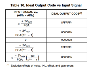

    and i got some answer in TI forum like for negative full scale need to add 800000h and it give 000000h the for 0 add 800000h  then it gives 800000h then for positive scale need to add 800000h then it give FFFFFFh so its like varying 0-16777215 .

  • Hi sagar m,
    The table below shows how the input voltage can be mapped to the ADC output code for the ADS1256. As the datasheet states, these values are encoded using a binary two's complement scheme. Therefore, if you convert these code values from hex to decimal, you see that:
    • 7FFFFFh = 8388607
    • 000001h = 1
    • 000000h = 0
    • FFFFFFh = -1
    • 800000h = -8388607
    So when your ADC outputs FFFFFFh, the input voltage to the ADC is a very small, differential negative voltage. It is not 16777215. That is why you must perform the sign extension in your software, to ensure that you are interpreting the data correctly i.e. to make sure you are reading negative differential voltages as negative.
    Let me know if anything else is unclear.

  • Thank you so much Bryan, for different gain changes its clear.
    For differential it's ranges from  -8388608 to 0 (-ve full scale) and 0-8388608 (+ve full scale) right.
    For single ended if i used 0-5V pot it ranges from 0-8388608 , if input is negative we can convert it by signed conversion that's all right
