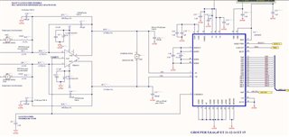

We are in a bit of a bind. We just produced ten boards that each use 8 ADS8422, four on the top layer and four on the bottom.
The problem is that the four ADS devices on the top layer only, output about 0.15 VDC on COMMOUT instead of the REFIN/2 specified in the datasheet. Reading a sample from the ADS produced a 0x0000 (hard zero).
The four devices on the bottom layer all output about 2 VDC from COMMOUT.
All COMMOUT pins are used on pin 2 of their respective op amps. Removing the op amp from one of the defective channels raises COMMOUT to 0.5 VDC.
REFOUT puts out about 4.1 volts (OK) and this is connected to REFIN. The device is therefore not in analog power down mode.
I checked all the other pins either with a multimeter or an oscilloscope, and they are all normal, in fact identical to the values on the bottom layer devices.
What kind of situation would cause an ADS8422 to output such a low voltage while REFOUT works fine and REFIN is connected to REFOUT?
