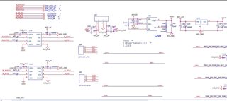

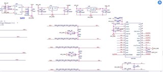

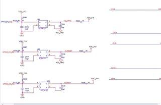

We use the ADS1256 in our project and now we have below technology support:
We adjust the input voltage amplitude but the output data is error, and please kindly review the below schematic diagram, programm and testing result, and advise why this result is error thanks.
  • Hi Zhang Liang,
    What signals are you applying to the ADC, and what is the ADC output? I.e. what is the error you are getting?
    Does the issue occur on all channels?
    Have you confirmed that the SPI communication and timing is valid using a logic analyzer?
    Please provide more details about what you want your system to do, the results you are getting from the ADC, and what you have done to troubleshoot this issue
    -Bryan
  • Hi Bryan,
    1. This is the differential signal input, and the data read from the register is right;
    2.We update the 8channels analog signal input to 4 channels differential signal, the result from SPI is -10000+--100000, and this data will no follow up the input voltage;
    3. The reference voltage is 2.048V;

  • Hi Zhang Liang,
    Let me rephrase some of my questions:
    1. Can you tell me what voltages you are applying to the ADC, and what is the ADC output code? For example, if you apply 1V to the ADC, do you get an ADC code that is the equivalent of 1V? If not, what do you get?
    2. How much error are you are seeing? I did not understand what this means:
      -10000+--100000,
    3. Have you confirmed that the SPI communication and timing is valid using a logic analyzer?
    I would try applying a known signal from a precision source to determine if you can measure this signal accurately. For example, apply 1V to the ADC inputs and see what you get at the output. You might also try bypassing the resistor divider so you can rule out this source of error.

    How to  confirm when the ADC srart  sampling instant;
    How are you controlling sampling? Are you using the SYNC/WAKEUP command or the SYNC pin? Either way, synchronization occurs after the START pin is taken high or after the first SCLK used to shift in the WAKEUP command. This is described on page 27 in the datasheet
