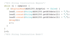

Hi i am writing a driver code for the ADS1293 to work with the ESP32. Using my code, I am able to read most of the data output by the ADS1293 properly but certain values which I am reading are junk and it is ultimately rendering the ECG signal useless.
The code is based on the opensource library written by Protocentral on Github. Here is the link: GitHub - Protocentral/protocentral-ads1293-arduino
Here are some snippets from my code:
I have modified their library to set R2 rate to 4 and R3 rate for all channels to 32.
Channel 1 graph looks fine (except the noise from AC line)
But channel 2 graph contains some stray values due to which it loses shape
Among a stream of good values, I am reading some stray out of bound values like this
Can you throw some light like what might be the issue??
