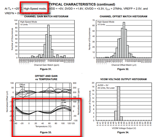

The gain error VS temperature curve is tested under the high-speed mode conditions, do we have the gain error VS temperature curve with low speed mode?

Hello Kailyn,
I will need to research any additional data that we may have. I will provide an update to you tomorrow.

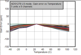

Hello Kailyn,
Here is some additional data that shows Gain error verses temperature for low-speed mode.
