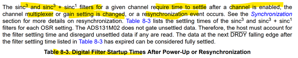

Question: ADC data is stable for a long time,about 3ms. Is it normal?
Description:
ADC channel input:  voltage change from 0 to 1.063V within 1ms,
ADC data output result: Read data through SPI communication,0 to 1.063V within 3ms
ADC configuration: The data output rate is 32K ,External crystals is 8.19Mhz . All other Settings are default,and reset after power-on
Data is read every  300us
Time      output (V)
0.3 ms    0.288
0.6 ms    0.6768
0.9 ms    0.9264
1.2 ms   1.0152
1.5 ms    1.0488
1.8 ms    1.0584
2.1 ms    1.06128
2.4 ms    1.06224
2.7 ms    1.06272
3 ms       1.06296
3.3 ms    1.06296

    Data settling is only applicable right after power up, right after a synchronization event, or when some of the settings are changed. The times are given in the table in the datasheet.
    However, you're asking about a bandwidth and slew rate. Assuming your signal was periodic, you're asking if the signal can rise and fall (at the faster slew rate) in 2ms which corresponds to 1/2ms = 500Hz = f_period which is well within the ~3.2kHz bandwidth afforded from 32kHz sample rate.
