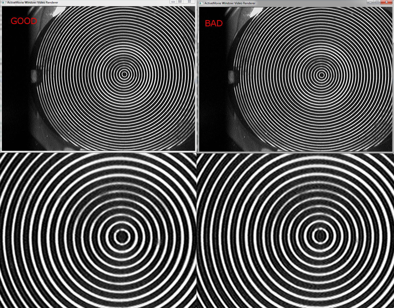

I'm using a TVP5147PFP to capture greyscale square pixel PAL CVBS from a video camera, which on the whole is working. I'm using this with manual gain, as we need computer control of this setting for our application.
I've got a really strange problem however, if the video feed is removed for a couple of seconds and plugged back in, or if either of the manual gain controls are used (course gain on input channel or fine control on cvbs luma), occasionally I start to get a slight artifact on screen which appears to be a horizontal shadowing or reflection.
The only way I've found to then get rid of the artifact is to reset the tvp5147, which is a pretty brute force method. I've tried every obscure setting in the datasheet, but nothing seems to affect this issue. This also means I need to do a full reset and chip configure sequence every time video unplugged and replugged, and every time either gain setting is changed.
Can anyone shed some light on this issue? I've attached a couple of example images. Just for reference the image is of a reflective ball with rings of light shone on it, the rings are then used to make a 3d map.
On the bad image (right hand side), particularly in the close up, the reflections are evident - these are causing issues with computer processing of the image. The clarity of the reflections does change with the brightness contrast settings etc, but these two images were captured with exactly the same on chip settings, the only difference is for the right hand one, I unplugged the vide and plugged it back in, and that's all it takes to get a different image.
I've seen identical artifacts in the past from grounding issues, is there some other setting in the chip, as it's trying to lock onto a signal, that would affect the input impedance or something? Perhaps this could cause it? I'm really at a bit of a loss.

    I'm really not seeing any significant differences between the two images.

    Did you view the image at full size? In particular if you look at the innermost black circle, the reflections are visible as lighter arcs. These appear on an otherwise identical image just by disconnecting and reconnecting the video feed. Then while the feed is connected, if I reset the chip and apply the same exact settings, the image is again identical without the reflections.

    OK, I now see the difference at the innermost black circle.  Also, the bad image does not appear to have exactly the same overall gain and offset as the good image.
    The TVP5147 initializes certain registers whenever loss of lock is detected.  It may be possible that these registers are not being initialized exactly the same during loss of lock and during reset.  Also, the AGC may be updating certain registers such as the analog offset (see below) before it is disabled following reset.  As an experiment, try enabling the AGC momentarily following source disconnection/reconnection and then restore the desired coarse/fine gain.

    I've had a chance to test the autogain, unfortunately there's not change seen. I set up a physical switch to switch between autogain, then back to manual gain. With the shadows present, switching to autogain or back again made no difference whatsoever.
    I did find however that switching the input channel to an unused channel, then back to the correct one would sometimes fix it. It seems somewhat dependant on how long I leave it on the other channel, ie switching there and back quicky (less than half second) only fixes it about 1 in 5 times, leaving it switched longer (2-3 seconds) fixes it almost every time. It's not a reliable fix however, even waiting for 5 seconds didn't fix it every time, and the full chip reset is much quicker than that (about 2 second process to video being active on screen).
    I also had some tvp5147m1 on hand so replaced the chip on one of my test boards. Once the patch code loading was implemented I tested it, and I actually can't seem to reproduce the shadowing effect at all, so it's either fixed or at least  vastly reduced in the M1 rev parts. The captured image however is somewhat different to the P rev part, I"d say it's slightly better, with less noise. While this would normally be a very good thing, unfortunately due to the software testing being finished with the current hardware, there's no chance to upgrade the part without invalidating a good part of the testing, deadlines mean retesting isn't going to happen for this release. I'm going to have to stick with the full chip reset for now I think, and just be ready to move to the newer chip in future if/when I get a chance.
