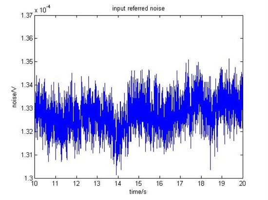

I got a problem with the input-referred noise.It is said on the datasheet that the peak to peak noise of ADS1298 is 3.5uV when analog supply=3V,reference volt=2.4V,output data rate=500sps,PGA gain=6 and the device is in the high resolution mode.But when i  follow the procedure written in page 78 of the datasheet to check the input referred noise using a circuitry designed by myself,it seems that the noise is about 130uV.This is the plot of noise.I don't know what is wrong.

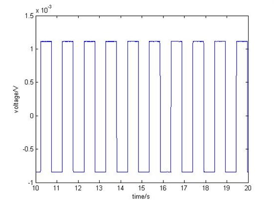

i also upload the plot of the 1mV internal test signal.

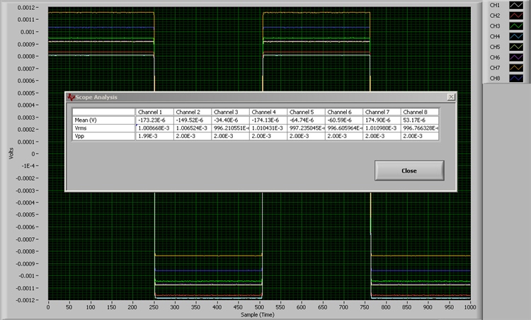

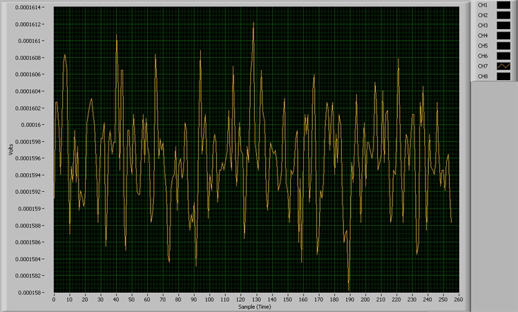

    Thank you for sharing your ADS1298 data with us!  The input referred noise is uVpp, so you should not include the DC offset.  Looking at your first plot, it seems you have something on the order of 5uVpp.  Below are a couple screen captures from our software.  First is all eight channels, second is CH7 by itself.
    The test signal (again ignoring offset) looks to be about 2mVpp.  I actually see similar results, when the TEST_AMP bit is cleared, I see 2mVpp and when set the amplitude looks to be 4mVpp - both are twice the value noted in the register tables so I'll look into that a little more.  Some additional screen shots for you showing the test signal - first all eight channels followed again by CH7 alone.

             Thank you so much. I shoudn't have include the DC offset.But the noise i got from my circuitry seems to be a little bigger than yours.I will check my circuitry again and see whether i can do some improvement about it.

  • Your noise does not look all that bad actually considering the amount of data you have gathered.  Note that the specification on page 4 for 10 seconds of data is typically 5uVpp, which is about what I saw in your graph.

  • The test signals are +/- so the 2mV and 4mV levels are normal.

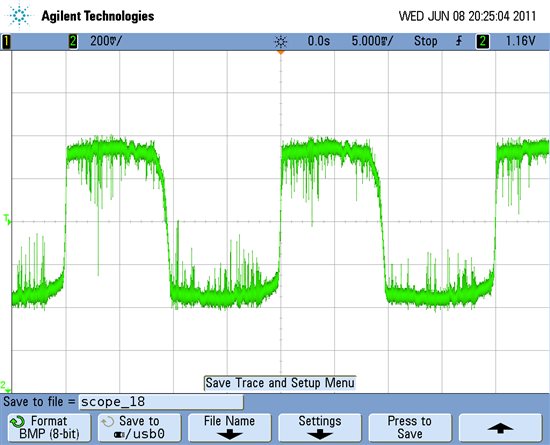

    I would like to confirm the procedure for conducting the noise test like what you have done. I have configured the registers according, I input NOTHING to the chip as the test signal is generated internally, I observe the result at pin TEST_PACE_OUT2, as I am using channel 1 and it is output at PACE_OUT2 by default.
    Am I right please?
    Because this is what I observed at pin TEST_PACE_OUT2, I just don think it is correct at all. With the setting you have, I expect the signal have freq = 2.048MHz/ 2^21 = 0.9765Hz, but the signal below has frequency 50Hz, is it because I am powering it using a power supply plugged into main socket?

    According to the "Test Signals (TestP and TestN)"subsection of "INPUT MULTIPLEXER"section,i am afraid you have to use TEST_PACE_OUT1  and TEST_PACE_OUT2 to monitor the internal test signal rather than only use TEST_PACE_OUT2. The default value of PACE Detect Register doesn't mean that you can observe the internal test signal only using TEST_PACE_OUT2 pin.The register seems only take effect when you use the PACE detection function in hardware approach.

  • NO,I didn't.As you see above,my plot have show you the frequence of the square waveform.
