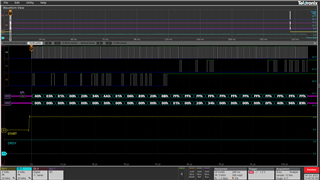

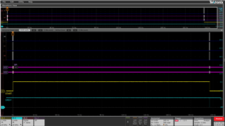

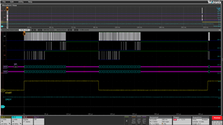

    3. Following are the screenshots of register settings, the OFC register values, and the START pin status.
    The above image contains the register settings applied and read back during initialization.

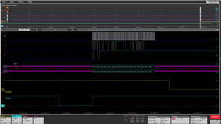

    The above image shows the SELFOCAL command being sent
    The above image shows the Initialization and SELFOCAL command sent. I am using two ADCs that share the same bus so I pull START of ADC1 to low before Initializing ADC2 with the same register values and then I pull START to high again to send the SELFOCAL command.

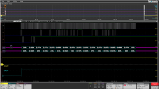

    The above image shows all the register settings and values after calibration is done including OFC registers.

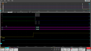

    The above image shows the zoomed-out version of when calibration is done.
    The above image shows the whole communication. Since my SPS is 80, the calibration should be done after 200.26ms as specified in the datasheet, but when I checked I found it to be about 211.75ms.

    Can you share your schematic? I see that you have the IDACs enabled and outputting 1mA each, and you do not have the internal reference selected as the ADC VREF (but it is enabled for the IDACs). So it will be helpful to see how the system is architected.
    The SELFOCAL only measures the ADC offset. If there are other offsets in your system e.g. before the ADC, they will not be removed by the SELFOCAL command. Have you tried measuring a known, low-noise input signal to see if the ADC can correctly convert this value? I would typically use something like a DP8200 as a signal source, and apply 1V to the ADC inputs then check the resulting code. Then I would incrementally introduce the remaining parts of your system e.g. IDACs, reference resistor, etc., to see if I could identify the source of the error.
    -Bryan

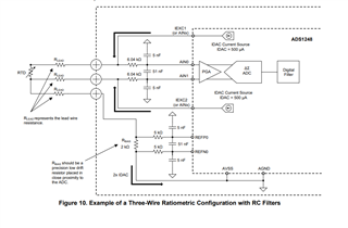

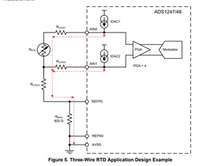

    My design schematic is more or less the same as those described in figure 5 of Application Report SBAA180B and figure 10 of Application Report SBAA201. As you can see that there are no active components in the external circuitry. The external circuitry only includes passive components which are RC filters. Therefore SELFOCAL command should be enough to remove the offset caused only by the input multiplexer inside the ADS1248. On the other hand, the SELFOCAL command disconnects the selected inputs from the internal circuitry and applies a zero differential signal internally, connecting the inputs to mid-supply (Section 9.4.5.3.1 of ADS1248 datasheet), so the external circuitry does not matter. Also, when the SELFOCAL command is not used the output value of the ADC is very close to the expected value (OFC registers = 0x000000) at the input of the ADC, but when SELFOCAL is used the output value is far from the expected one (OFC values loaded by the ADC itself after SELFOCAL command), which is quite weird. Following are the schematic screenshots of the figures mentioned above.

    Thank you so much for your replies to my questions. I fixed the issue. While initializing the ADCs I was writing 0x20 to MUX1 which was selecting REFP0 and REFN0 as reference inputs, therefore when I send the SELFOCAL command without any RTD connected to the analog inputs of the ADC, there is no reference input for the ADC to calculate OFC. So, during the calibration process, I sent 0x30 to MUX1 which means, Internal reference is selected then I send the SELFOCAL command, and voila OFC is calculated correctly because now there is reference voltage for the ADC. When calibration is done I simply change the MUX1 value to 0x20 for my RTD application.
