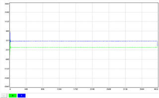

    2. To receive the data, we removed the transducer and make the 7332 not transmit any signal. Then we observe the received data. At the very beginning, the data of channel 1 (appear as "0") and channel 2 (appear as "1") are as following:
    We bypassed the digital processing. Therefore, the offset is there. Both signals are okay in our opinion.

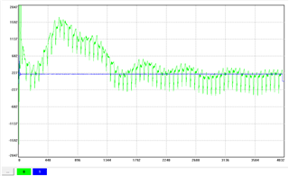

    However, after 5 seconds of performing the data-receiving process, the data of channel 1 (appear as "0") and channel 2 (appear as "1") becomes as following:

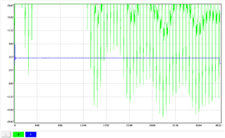

    After another 5 seconds of performing the data-receiving process, the data of channel 1 (appear as "0") and channel 2 (appear as "1") becomes as following:

  • Hi Yinhui,
    Thanks for sharing the data. Its very useful.
    It looks like some sort of systematic issue and we haven't seen such kind of noise from the ADC in the past. It's quite unique and I think something else outside the ADC is coupling at the same instant when odd channels are getting sampled.
    I am saying this because the same ADC samples the odd and the even channels.
    So in you system could you identify something which is running at a lower frequency and could couple with the signal chain.
    Looking at the data it looks like some periodic noise is entering the system. And from the waveform looks like it is a factor 64 with respect to sampling.
