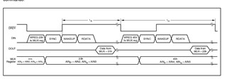

4. We set the data rate 1000SPS, and we measure the input multiplexer Cycling, and the t19 is 1.9ms which is diffenect from the datasheet t19 less than 1.19ms(837Hz);
    How did you determine the timing? Did you use a logic analyzer? If so, can you send me the logic analyzer timing diagrams so I can review?
