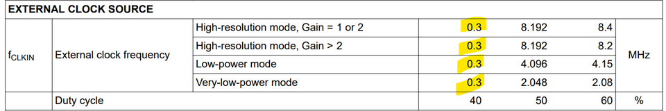

    For a small clarification, SCLK in phase with CLKIN will give the best performance but if CLKIN is not synchronous with SCLK, you won't get bad performance, just not the best.
    However, because of the way our synchronization algorithm works, the fact that you're using multiple devices, and the recommendations in the datasheet (below), I highly recommend, as you said, getting a MCU with a local oscillator that can fan out to all the devices so everything is synchronized. The short of it, is if you choose to have a local crystal oscillator at every separate ADC, the jitter, drift, and exact frequency is unknown so my previous "synchronized within 1 t_CLKIN period", will not hold true and you'll have to do some tolerance calculations on the crystal and determine the typical error between conversions for your system.
    Also, to answer your question, yes 8MHz (as opposed to 8.192MHz) is fine to use and within the clock specifications for each of the modes of the device, as shown below. The problem is that the output data-rate, bandwidth, and f_MOD will scales with the CLKIN so you'll just have to recalculate what these important values will be. I've already sent the SAR vs. Delta-sigma TIPL video on the other post so you can use that as a reference if you need a refresher. 8.192MHz is an industry standard and helps with other base 2 type calculations on a MCU so keep that in mind.
