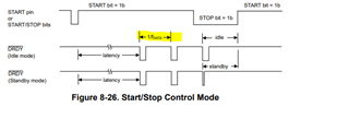

In start/stop control mode, is there a formula to calculate the time between ~DRDY going low (indicating data ready) to the shift register being filled with the next bin of samples? If not, can you please tell me how I can roughly estimate the time between these two events?

    DRDY goes low every data rate period, which depends on the OSR setting and the CLK period.
    t-DRDY=2*OSR*t-CLK
    The next conversion data is updated 2 CLK periods before the falling edge of DRDY.  Total time from DRDY falling edge to next conversion result loaded into shift register (SR), t-DRDY_SR
    t-DRDY_SR=2*OSR*t-CLK - 2*t-CLK
    t-DRDY_SR=2*t-CLK(OSR-1)
    Please keep in mind that the time t-DRDY_SR is when the internal register is updated, but data cannot be clocked out of the device until 2*t-CLK after DRDY falling edge.
