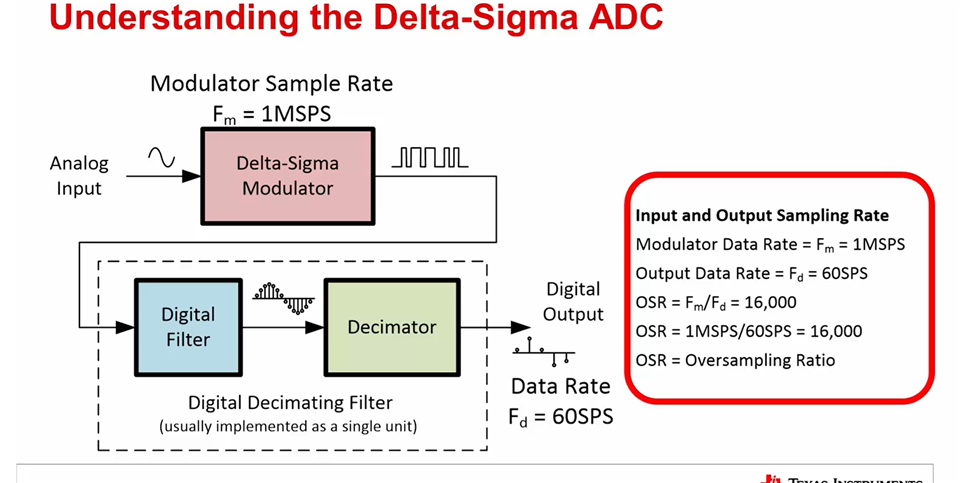

    This is an interesting way to force starting a conversion when the device clearly isn't design to do single shot conversions or have the user reliable control when conversions occur. I haven't directly tested this but my guess is that the FIFO is still full of data (assuming you haven't cleared it) as SYNC triggers a new conversion start in global chop mode. When DRDY is not toggling at the expected rate, this is usually the issue. So, the fix would be: switching to chop, clearing the FIFO using the methods in the datasheet, and then toggling SYNC to start the "first conversion" process you illustrated above.
    However, the easiest way to control data rate is to control your f_CLKIN. f_data is proportional to f_CLKIN (or f_mod = f_CLKIN / 2) and OSR. The picture below should help.
    This is true of all delta-sigma ADCs. I'd use an MCU with a clock output and dynamically change that number in the firmware.
