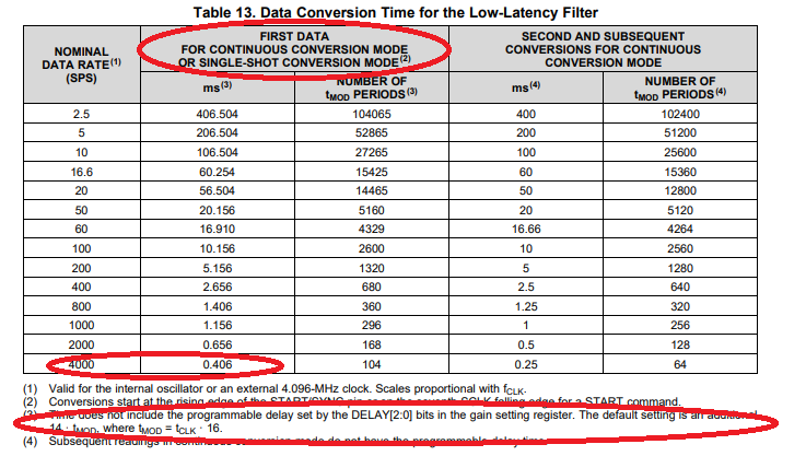

Our customer is using it by setting DATA RATE = 4000SPS, and when drdy is ready, it sends start again to check the repeated sampling period.
It is confirmed as 450us, not the theoretical 250us. Please check what the problem is.
Below is the customer setting, please refer to it, and please guide the necessary items sequentially or source code for the register setting related to the data rate setting.

    I think there is a misunderstanding as to how the device operates.  Table 13 from the ADS124S08 datasheet shows the time for conversion when using the low-latency filter.  Note the areas circled below:
    When in single-shot mode, the conversion is nominally 406us + the default delay of 14 tmod periods which is about 55us.  So the total time after the START command is issued is 406us + 55us which is 461us.
    When operating in continuous conversion mode the first conversion will still be the 461us with the second and subsequent conversion at 250us.  This behavior is shown in the next set of columns to the right.
