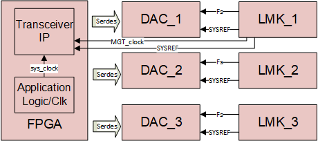

    Above is the RX side in DAC chip of JESD204B. I have another question about the TX side in FPGA of JESD204B. Let us say I have 3 DAC39J84 ICs (a,b,c), which are clocked by 3 LMK04828 ICs (a,b,c) respectively. The dclk and sclk can be named as three pairs: dclkout2_a and sdclkout3_a, dclkout2_b and sdclkout3_b, dclkout2_c and sdclkout3_c. When I instantiate three JESD modules (each module for one DAC39J84) in FPGA, shall I use its own dclk and sclk pair (dclkout2_a and sdclkout3_a for DAC39J84_a, dclkout2_b and sdclkout3_b for DAC39J84_b, dclkout2_c and sdclkout3_c for DAC39J84_c), or use one common pair for all the modules (dclkout2_a and sdclkout3_a for DAC39J84_a,dclkout2_a and sdclkout3_a for DAC39J84_b,dclkout2_a and sdclkout3_a for DAC39J84_c), or other combinations?

  • Hi Yilun, kindly see my comments below.
    The ±1 VCO cycle error of LMK device clock is not deterministic (I have a statistics, 80% are ±0 VCO cycle error, 20% are ±1 VCO cycle error), which probably means 80% DAC output is good, 20% DAC output is shifted ±1 clock. Do you agree here?
    Correct, if the VCO cycle error is not consistent then there is no way to guarantee the DAC outputs will be aligned or shifted every power cycle.
    Maybe I have to solve the LMK synchronization first?
    Absolutely. I would suggest to create a new thread with our clocking team to receive faster support on this.
    Regarding the FPGA clocking, only a single MGT clock needs to be passed to the FPGA if the serdes are connected on neighboring quads (as typically an MGT clock is capable of being shared to one quad above and below). In this case, the SYSREF can be common.
    If quads are not neighboring, then you will have to pass a second MGT clock (and SYSREF) for that particular quad, etc. But, assuming the LMK outputs are aligned, this should not cause issues.
