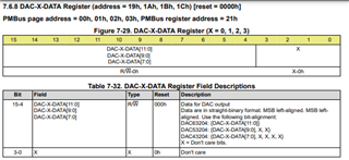

    And the output is changed using the DAC-X-DATA Register based on the equation given in the current output mode section:

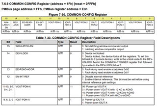

    Each channel is set to be in current or voltage output mode in the COMMON-CONFIG Register.
    So if you are in current mode you set the range via the DAC-X-IOUT-MISC-CONFIG Register and if you are in voltage mode the range is set by the reference and gain setting chosen in the DAC-X-VOUT-CMP-CONFIG Register.
