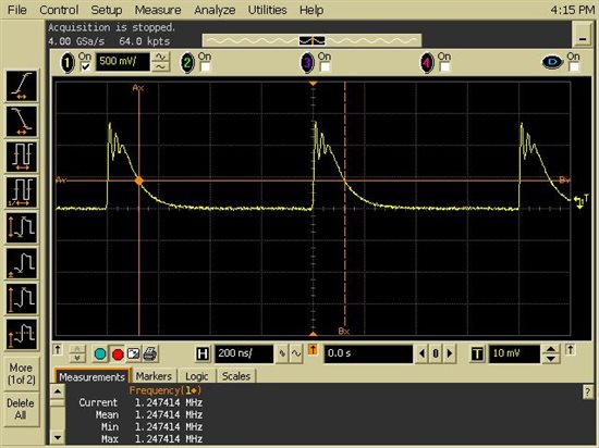

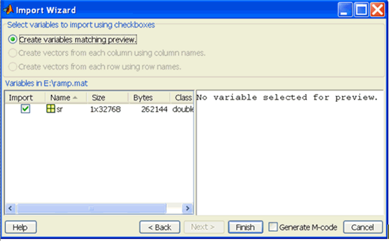

    Hi Hamza,

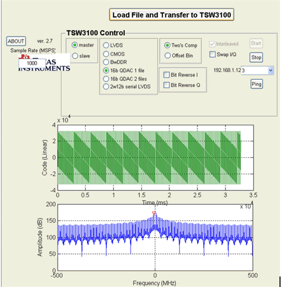

    I used your code but some how I does not come out as expected. Please see attached files.
    Does the ramp.mat file suppose to repeat by itself. If it does not ,could you modify it to make it repeat itself?
    Secondly, the signal I see under oscilloscope show ~ 1MHz signal not 5MHz
    thks,thu

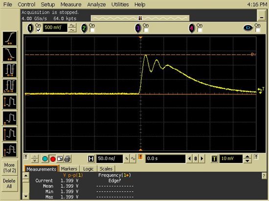

  • Thu,
    The TSW3100 will repeat the pattern continuously.
    Since you are evaluating the DAC5681 EVM, you will need to select LVDS output from the TSW3100 instead of the 16bQDAC 1file. Also, the transformer output is a high pass filter response. It may filter out the low frequency contents.
    If you want the unfiltered ramp response, I would recommend you remove the transformer and use resistor termination instead. Replace R7 and R13 with 25ohms and install R109, R134, R6, R15, and R9. Remove the T1 transformer. The differential output will be at J1 and J2. You can use a differential scope to see the ramp.
    In addition, I would also check the feedback clock from the CDCM7005 to see if it is set up correctly. You can refer to the DAC5681/2/2z EVM user's guide and TSW3100 user's guide for more detail.
    -KH

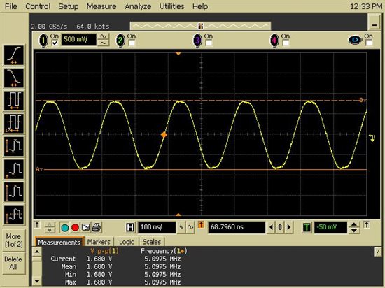

  • Hi Kang,
    You mentioned that T1 has HPF response. I was using TSW3100 Control to generate 5.1Mhz signal and it shows fairly decent response.
    Is T1 really limiting factor?
    thks,thu

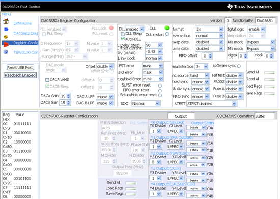

  • Thu
    Find attached sample configuration files for DAC5681 and CDC7005, for 1 GSPS DAC5681 operation.
    DAC5681 is single channel DAC so any settings that are applicable to DAC B (2nd DAC channel on DAC5682z), should be left to their default values.
    cnfg.zip
  • Hi Hama,
    1) The values which I read from my board are little different from yours. Please advice:
       Hama's file                 Thu's data
       5F                                       5F
      00                                       10
      C0                                       80
      73                                      70
      00                                      00
      00                                      00
      0C                                     2C
      FF                                      FF
      00                                      00
      00
      C0
      00
      00
      00
      00
      00
    2) Can I replace T2 (ADT4-1T  -  BW :9-600MHZ)  with ADT1-1  (50 ohm  BW: 0.1 to 400mhz).  ADT1-1 has no center tap
         With R22=R26 = 25 ohm?  . With this I can cover lower frequency responses?
    thks,thu

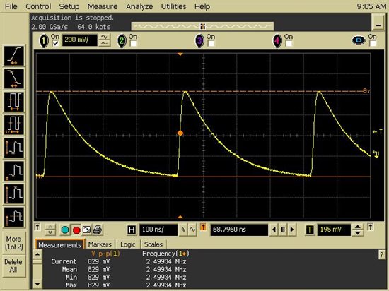

    I think that it's generating ramp response. It's,however, the frequency is 2.5mhz instead of 5mhz?
    Could you suggest where to look for error?
    thanks,thu

    The output frequency is 2.5mhz?

    1) Input clock and sampling CLK  =1000mhz  => Ramp output frequency =2.5mhz
    2) Input clock and sampling  CLK =100mhz  => Ramp output frequency =0.25mhz
    I reduce clock by factor of 10 , the ramp output frequency also reduces by factor of 10 . Does this result implies something?

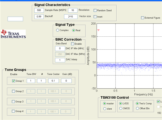

    I have double checked my settings by running a DAC5681 here. A snapshot of my DAC GUI is attached and it runs fine.
    You should check your clock sources.

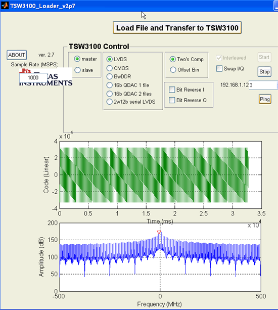

  • hello Hamza,
    I load your Mat Lab program and using your config files but the output signal is 2.5mhz instead of 5mhz.
    Could you help to pin point the issues?
    thks,thu
    Hardware: TSw3100EVM / DAC5681EVM - input CLOCK=1000mhz
                         Transformer has been removed. Monitor with differential probes
    3771.ramp.zip
  • Thu
    I have found a bug in TSW3100 Loader program because of which it works fine for loading complex data (dual channel) into the TSW3100 but not for real data (single channel).
    For a work around, please use the following MATLAB code to generate the loading file:
    fs = 1000e6;
    fin = 5e6;
    N = 32768;
    B = 16;
    t = linspace(0, (N-1)/fs, N);
    w = 2*pi*fin;
    sr = 0.99 * sawtooth(w*t);
    sr = round(sr * 2^(B-1));
    sr2(:,1) = sr(1:2:end);
    sr2(:,2) = sr(2:2:end);
    save('ramp.mat','sr2');
    I apologize for inconvenience. We will correct it in our next release.
