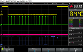

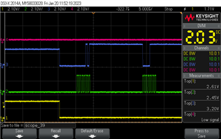

    Thanks for providing your register configuration. Can you provide timing plots captured with an oscilloscope including /CS, SCLK, DIN and DOUT? that will be very helpful to address the issue. Also, can you clarify the data for which channel in your image? it will be great if you can share your raw data.
    Dale
  • Hello Dale,
    Thanks for the update Currently I am unable to provide the timing plots if you can't do anything without timing plots then I can arrange the timing plots. And In the Image, it is the second channel. Only the first channel is working fine other 3 channels are behaving the same as you can see in the shared image. But it's happening in the simultaneous sampling only. when I am enabling the one-by-one channel and reading the data then all channels are working fine. I am also sharing the Raw data of channel 2 on enabling the simultaneous sampling.

  • Hello Dale Li,
    I am sharing the timing plots of an oscilloscope where Yellow is CS, Green is SCK, Blue is MISO, and RED is MOSI.
    Sarthak Malik

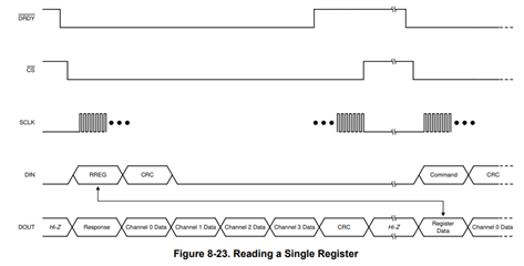

  • Hi Sarthak,
    A whole frame data should be similar as the following timing, the first word is status or register data, then the data for CH0, CH1, CH2, CH3, the last word could be CRC, each word size is either 16 bits, 24 bits or 32 bits based on your configuration. one or two whole frame data will be helpful and also a zoom-in timing is very helpful as well. Thanks.
    Dale
  • Hello Dale,
    Sorry for the late reply, I am sharing the updated image please check.
    Sarthak
  • Hi Sarthak,
    No worries, thank you for providing the timing image. Your timing shows that the data of CH0/CH2/CH2 are zero and the data of CH3 is 0xFFFFFF, are all channel inputs floating or short? what's the data of the first word which should be the status register?
    PS: What you did (disabled timeout, set gain to 64 and phase delay for each channel) by writing the registers should not impact data output.
    Dale

  • Hi Sarthak,
    From the timing you shared, these data (zero and the data of CH3 is 0xFFFFFF) on the DOUT are correct data for floating input, so you are getting correct data for each channel. You can double check by using a DC input on some of channels, it will be clear for you to see if the data is output correctly for the corresponding channel.
    When you collect data, were you monitoring /DRDY signal? basically we keep monitoring /DRDY signal, we usually start selecting the ADC and collecting data when a falling edge of /DRDY is detected, a low /DRDY indicates that the data is ready for the microcontroller to read.
    As I said, your programming internal registers to set gain and phase delay should not impact data output, so I did not think you can get any improvement.
    Dale

  • Hi Sarthak,
    I might be interpreting the oscilloscope screenshots but the V_OH are out of specification then:
    3.3*0.8 = 2.64V and the high on the waveforms are 2.37V and less than 2.64V. Why is this?
    Can you send a picture of your schematic?
    -Cole

    3.3*0.8 = 2.64V and the high on the waveforms are 2.37V and less than 2.64V. Why is this?"
    Now,we have check V_OH=3.3V.But still we are seeing spikes on the input (analog) side.
    Please find the attached waveform.
  • Hi Sarthak,
    It does look a bit better but it looks like you might be violating the -0.3V pin absolute maximum (3.7Vpp-3.39Vtop = 0.31V). Its also very clear that the DGND is not 0V, or at least the Low state is below 0V on the waveform. In addition the High is higher than the 3.6V which is also out of spec. There is a risk that the device might have been damaged.
    Do you happen to have DGND and AGND split in your schematic that is connected at a single point? I see this sometimes when DGND and AGND are not connected together to a general GND plane with a via that is directly next to the pins.
    -Cole
  • Hi Cole
    DGND is 0 V and DGND - AGND is connected to each other.The -0.3V is due to Problem of Oscilloscope calibration.Please find the updated attached waveform.
    Best
    Sarthak

  • Hi Cole
    Please find the attached waveform:
    Thanks and Regards
    Sarthak
  • Hi Sarthak,
    Everything looks better now. That being said, 95% of time, fixing the levels will fix any stage behavior seen with data collection. Everything looks okay and I assume you're still getting the spikes on the input.
    I haven't see confirmation that you toggle RESET before collecting data (to clear the FIFO), but I'm going to assume you are doing that.
    As a result, I've sent you an email. Please keep an eye out for it.
    -Cole
  • Hi Cole,
    Yes everything looks better now but I am still geting spikes in the data. Yes I am toggle RESET before collecting the data.
    Sarthak
