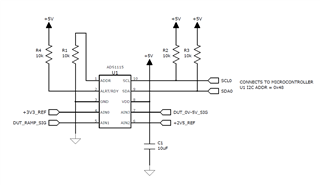

  • Hi Bob,
    Thank you for your response.  I have attached a schematic showing the implementation of the ADS1115.
    For the ADS1115 that is running hot, it runs hot regardless of the analog input connections.  Even with the analog inputs disconnected, it starts to heat up as soon as 5VDC power is applied.
    Right now, I don't see any way that I'm violating the maximum ratings on the analog inputs.  The signals all measure as expected when I measure them using a digital multimeter.  The grounding scheme is very simple.  The device-under-test (DUT) is a passive device (potentiometer) and shares the same ground as the ADS1115.
  • Hi Michael,
    It sounds like the device getting hot was damaged.  If one of the ESD structures is damaged as a short, then current will flow from DVDD to GND through the short.  This can happen if one of the analog inputs is powered accidently before the 5V VDD supply is powered.
    From your drawing it is not clear which device package for the ADS1115 you are using.  Also it is not clear from the drawing if there are any resistance at the input to the ADC inputs.  A 1k Ohm resistor in series with the input will limit any possible input current to less than the absolute maximum (assuming the grounds are common and no input voltage exceeds the intended voltage).
    I would advise that the ADS1115 is always powered prior to applying any external input voltage.  I would also advise that if power is at the inputs you do not disconnect the 5V VDD power to the ADS1115 to reset the device while the external input is still powered.  Here you must also consider that any capacitance at the inputs will hold charge, so the inputs should be completely discharged before turning off the supply to VDD.

  • Hi Bob,
    I agree that the failing ICs are most likely damaged, I'm trying to figure out what could have caused the damage.  If the most likely culprit is excess current through the analog inputs, then I can protect them with series resistors (as you suggested) and TVS diodes.  It's still mysterious as to how the maximum rating would have been exceeded, when no voltages above the maximum ratings are present.
    What about my initial question regarding the maximum sample rate?  We are running this device almost constantly at its maximum sample rate of 860 samples per second.  Would you expect that kind of stress to cause a failure?
    We are using the 10-pin DGS package, see the attached image from the datasheet.
  • Hi Michael,
    The ADS1115 is an oversampling ADC where the actual modulator frequency is the sampling rate (250kHz) regardless of the data output rate of 8sps or 860sps.  The ADS1115 can be run continuously without issue or overheating.
    As to the cause, it is difficult for me to troubleshoot a system that is not in front of me.  All I can say is what I have seen others do that can cause an issue.  I will review them again:
    • An overvoltage condition at the input occurred that caused EOS.
    • Grounds from all sources were not common to the ADS1115 ground.
    • Current not limited to the device using series input resistance.  An accidental overvoltage occurred that exceeds the absolute maximum input current of 10mA as a result.
    • Power applied to the inputs accidently while the ADS1115 was not powered.
    • An input signal source (such as a signal generator) that goes below ground or above VDD.
    Bob B
