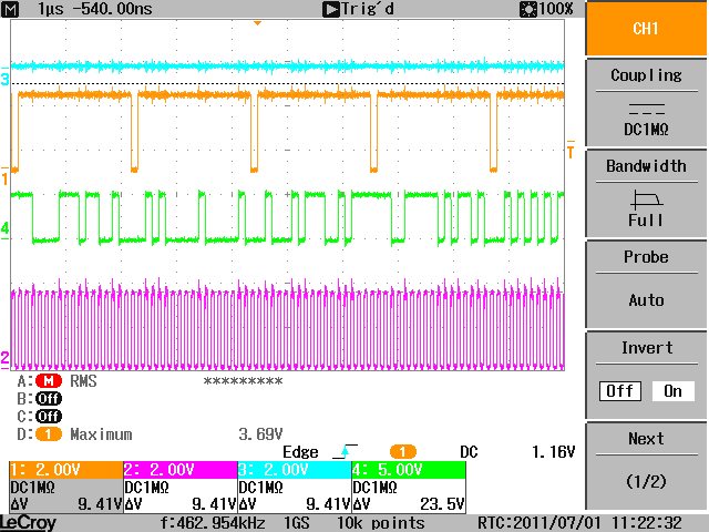

    I'm using an API I wrote for the SSI0 peripheral (that's where all of the parameters passed to "configSSI()" come from, and the rest of the functions, this API is used in the Stellaris code examples I've posted in the design notes section). I set up the SSI port for 9 bit frames, phase = 1 (I think think phase matters with this device), polarity = 0, and I set the clock divider for the SSI clk to be sufficiently slow such that we're guaranteed that DRDY has pulsed on each acquisition. Your clock divider settings will depend on how your clocking your LM3S811.
    I have MOSI connected to R/C, MISO connected to DATA, SSI0FSS connected to CS, SSI0CLK connected to DATACLK. With the Stellaris SSI peripherals if you don't apply any delay between SSI writes you can actually smash the frames together. So we use two 9 bit frames to create the illusion of a 18 bit frame. The first SSI write gets 0xFF so that we see the appropriate pulse on R/C and the second word is 0x1FF to keep the line high for the rest of the frame. CS goes low for each frame, but since I'm constantly writing CS always stays low.
    Since this interface uses only native features to the Stellaris SSI peripheral you can still use uDMA to collect data, you'll just have to do some massaging on the back end to put the data back together. I'll have to do a little more work to get the data massaged correctly for some nice sample code, I'll let you know when it's posted.
    Blue - CS
    Orange - R/C
    Green - Data out from ADS8509
    Purple - SCLK

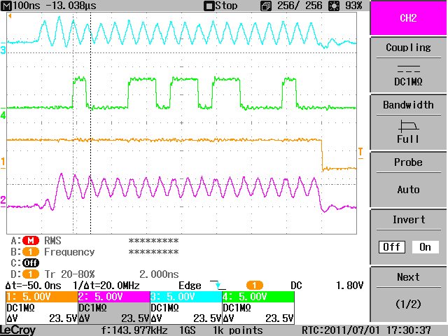

    So, what I've done is tie CS to ground, increase the SCLK frequency to 25MHz, increased my frames to 10 bit frames (what looks like a 20 bit frame since they're smashed together), and added a delay between each pair of frames. MOSI is still tied to R/C, all the other connections remain the same except CS is grounded. Phase and polarity become important since this interface requires some rigging, Phase = 1, Polarity = 0.
    I'm still getting close to the maximum throughput from the device and I've tied uDMA into the acquisition cycle. You can see a scope shot below, it looks nasty but it works:
    Blue - SCLK
    Green - Data Out
    Yellow - BUSY
    Purple - R/C

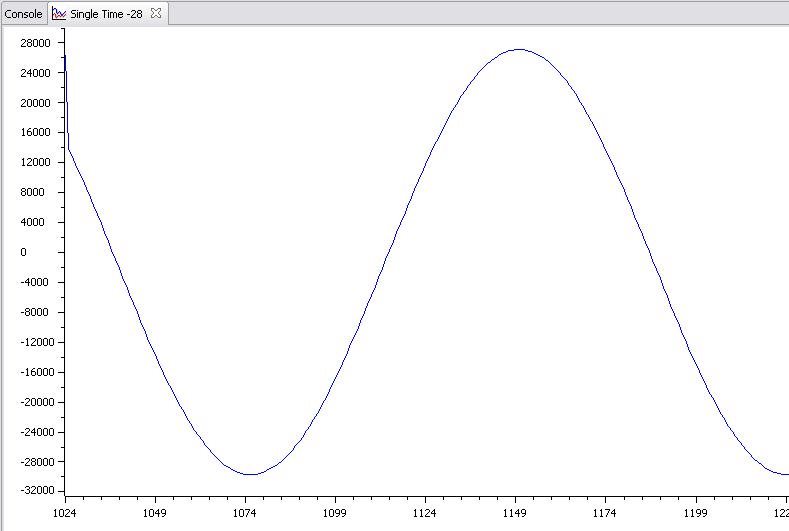

    And a screen cap of the resulting waveform:

    You can see we're actually getting all 16 bits moving in the resulting data, important to note since we have to manually do bit shifting on the data we collect through DMA. I'll be posting the sample code shortly.
