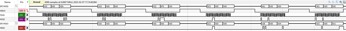

I've reflowed the DAC60508 to my board and tried to read the DEVICE ID unsuccessfully. I've verified the SPI mode to be correct, in mode 1, verified below. I checked the forums here and saw other comments recommending writing to the TRIGGER register to perform a soft reset, clearing the LDAC, writing to the SYNC register to clear BRDCAST enables, and clearing the CONFIG register to make sure FSDO is 0, despite that being the default value.
Subsequent SPI access cycles with the same MOSI bytes as above will return semi-stable but nonsensical values from the DAC, none of which are the DEVICE ID or even an echo of the first byte from the previous access cycle.

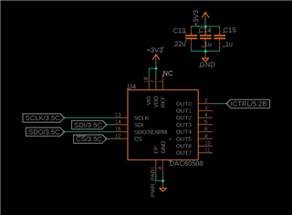

Here's the DAC schematic for my board:
I am currently debugging with a nRF52840, no lines are pulled up on the SPI, but the DAC is the only interfaced SPI device. I don't believe this would be the issue, but again I'm a bit new to this so it could be!
Any help would be greatly appreciated!

    Thank you for your reply. I was running the SPI clock speed at 500kHz here. I tried frequencies up to 8MHz with the same result.
    Adding a bit more context above, after the set of 6 access cycles above, I repeat the 6 cycles again a second later. The first three cycles then have bits on the SDO line that aren't present in the first set. In subsequent loops of the 6 cycles, the SDO line stays the same as seen below.

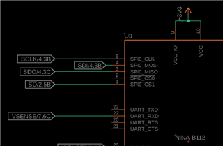

    If it helps, here is a screenshot of DAC placement and the pin headers I am using to interface the DAC with the nRF52840-DK. The microcontroller below it is not soldered onto the board.

  • Here is two consecutive loops of the write commands mentioned, with setting the DAC0 output to max.
    I've confirmed pin 1 voltage reference to measure ~2.5V.
    Repeated loops of writes the with setting the DAC0 to 0V results in this:

  • Hi Drew,
    Looking at figure 65 on page 29 of the datasheet, I am seeing SCLK being high as CS transitions to low. On your scope captures, SCLK is low when CS transitions. Can you change your SPI settings so it is idle high while making sure data is still latched in on the falling SCLK edge? Additionally, looking at your latest scope captures, when you are writing to register 8 to set DAC0 to full scale, the register data is actually left justified. So, to set the DAC to full scale output, you would need to write 0xFFF0, not 0x0FFF. Your write of 0x0FFF to register 8 and given the settings for the reference divider and DAC gain, you should see an output of ~0.155 V based on equation 1 on page 21 of the datasheet.
