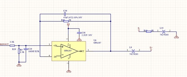

Hi
I use ADS1262 like below picture, when I change the input of one different-input channel , it will affect the output of the next differential chennel . For example, when I change the input of channel 1(AIN0,AIN1), keep the input of channel 2 (AIN2,AIN3), but the output of channel changed, I don't know why.

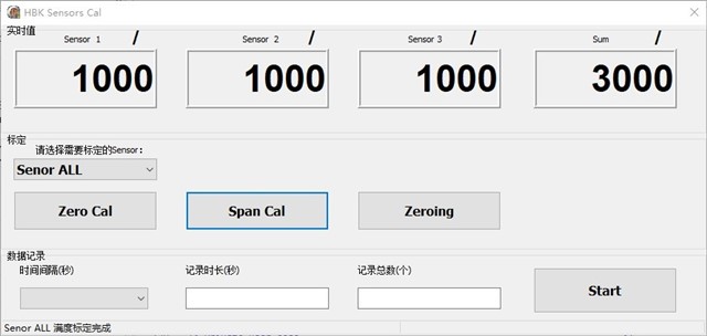

Hi Bryan:
What you understand is correct. we have a panel what can show the 3 sensors output .The ADS1262 collects signals of these thre e sensors' (the SPS is1200), the gain is 32, we add FIR digital filter. we calibrated the span digital output: 1000 for this three sensors , you may see 3 sensor's output is 1000 on the panel in picture1 . when change the output for the sensor 1, the other two sensors not change, it is strange the output for the sensor 2 also have some change,see the picture 2.

Hi Bryan:
In my test , all the three sensors biased full scale at the same time, each sensor show it's output 1000 in the panel. when I just change the siganl for the sensor 1 from full scale to 0 , the output for sensor 1's in the panel should change from 1000 to 0, and the others should keep 1000. But now , it has two problems , 1 i: the output for sensor 1 can't return to 0 , 2 : the output for sensor 2 can't keep 1000.
The data from ADC match the output in the panel. FIR filter is the digital filter like the filter within ADS1262 ,such as sinc.

Hi jinyan ma,
This might be related to a settling issue. I see that you have a filter on the output of the op amp that has a very low cutoff frequency (~400 Hz). Can you try reducing the size of the 100nF capacitor and/or 2kohm resistors? Even reducing them to 10nF and 1kohm gives you a cutoff frequency of 7.96 kHz, which should be sufficient to reduce the settling time compared to the ADC sampling rate (1200 SPS). You could also reduce the ADC data rate to see if this has an effect on the system.
