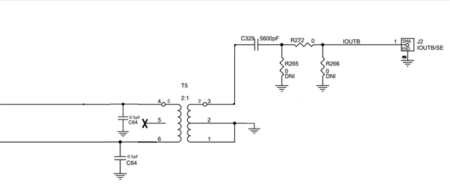

I see that the Barron model used for the official development board is TCM3-452X-1+.
The model number I use to design the schematic is TCM2-63WX+, how do I connect?
You should connect the balun following what the TCM2-63WX+ datasheet says like in the image below.
You will also need to populate C364, L1 and L2 to provide +1.8V to the DAC.
And as a note. Make sure to keep the decoupling capacitor C329.
