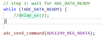

I have a really strange problem with my custom board (ADS1299 + Atmel SAMD21G18A): sometimes ADS1299 gives corrupted data, either from one channel, or from several channels.
My ADS1299 is working in single-shot mode, with internal 2.048MHz clock. The microcontroller sends START command at a frequency of 2000Hz, it waits for ADS1299 DRDY interrupt, then reads ADS1299 buffer. The ADS1299 sends data to the microcontroller via SPI (SPI baud rate 4M, ADS1299 SPS = 16k).  ADS1299 channel 1 - channel 4 for EEG data acquisition, channel 5 - channel 8 off.
I should mention that there is a small delay (~3us) in my code between ADS1299 DRDY and the start of microcontroller reading.
Below shows one example. As no electrodes are connected, I am supposed to get 7FFFFFh all the time. However, as you can see from the screenshot, some data got corrupted.
I connected a logic analyzer to the ADS1299 SPI pins, and this confirms the corruption of data before they are sent to the SPI line. Below shows an example (here channel1 data is corrupted):
The strange thing is, when I delete my delay (meaning that the microcontroller waits infinitely DRDY signal and launches read operation as soon as ADS1299 data is ready), this bug seems disappeared and I got stable data.
I tested with ADS1299 internal test signals (square waves), I changed SPI speed, same problem.

  • Dear Chien-Chun,
    Thank you very much for the detailed reply, and sorry for the late reply.
    I unfortunately don't have an EVM, I'll try to get one for further development.
    For my custom board, START pin is grounded, so it is always LOW.
    The microcontroller sends a START command, waits for DRDY falling edge to come, then sends RDATA command, then reads 27 Bytes data from ADS1299 buffer. This whole process is repeated at a frequency of 2000Hz.
    As ADS1299 is working in single shot mode, I do not use STOP command.
    The data rate [DR2:0] in my code is 000 -> 16kSPS.
    The delay (~3us) is located between the arrival of DRDY falling edge and sending of RDATA command.
    Hope this is clearer now.
    The question was: when I deleted this delay (meaning that the microcontroller reads ADS1299 buffer AS SOON AS a DRDY falling edge triggers, the spikes (data corruption) seem disappeared and I got stable data.
    The openbci post says "due to a small delay in reading data from the chip", whereas my problem can be rather described as "due to a small delay BEFORE reading data from the chip", if this could be clearer.
    Of course, I am not sure if my problem is indeed due to this delay, perhaps I did something wrong concerning SPI timing or something else. If you could give me some advice or inspiration, it would be really helpful.
