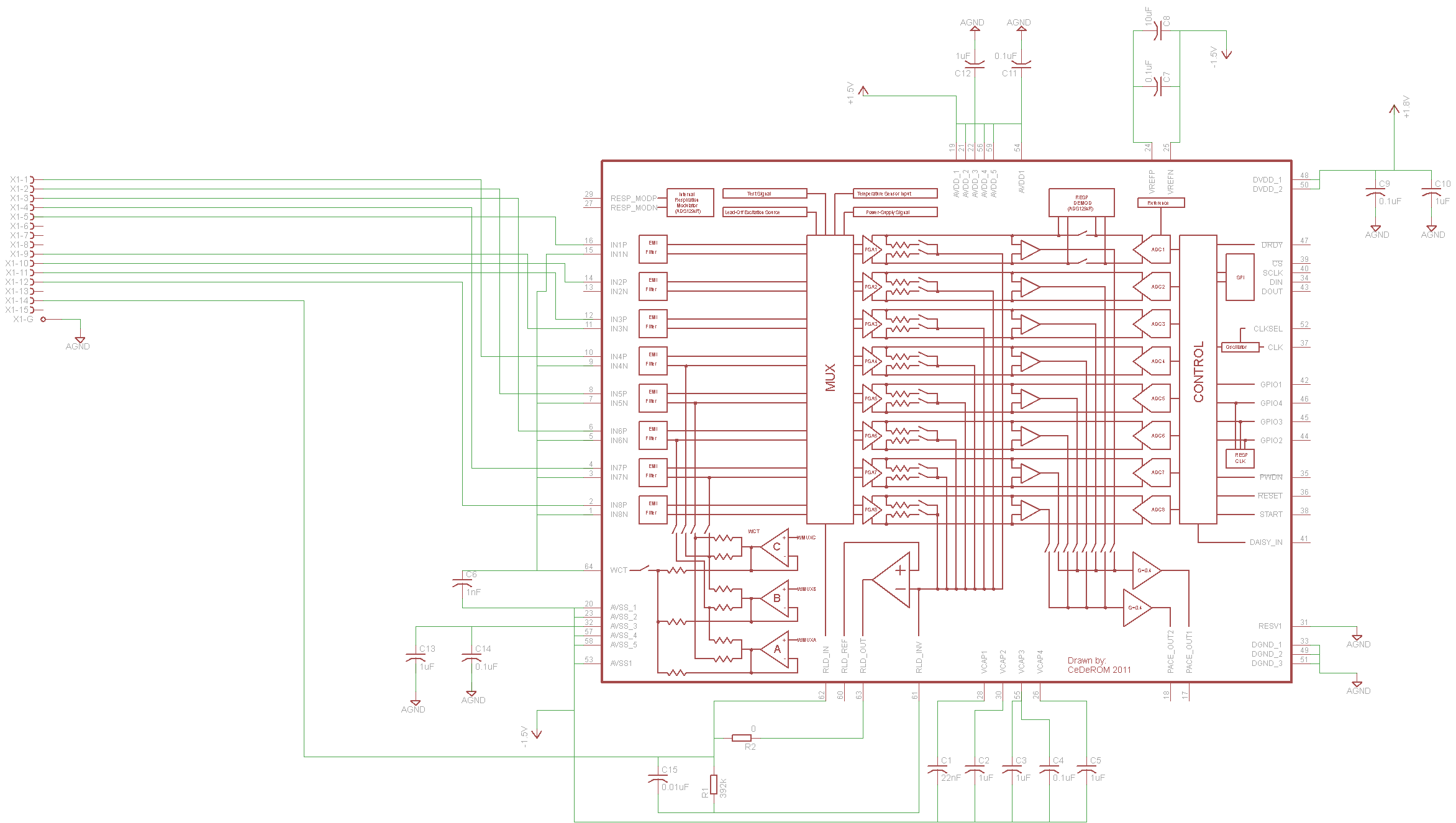

  • sorry, I do not tell me, the idea is ads1298 + msp430 + pan1315
    "lo siento, creo que no me explique bien, la idea es ads1298+msp430+pan1315 "
  • Juan,
    Sorry for the delay. Yes, of course it's possible to add a SPI device to the MSP430BT5190. Simply find a SPI port that's available, configure it and make sure your driver for the ADC works. Then you can transfer the data via bluetooth.
    Gustavo
  • Hola nuevamente.
    quisiera poder contar nuevamente con su ayuda. He comensado a elaborar una tarjeta con el ads1298 pero no me quedan muy claros aun unos conceptos acerca del manejo del marcapasos y el RLD_ref, me podria orientar nuevamente. adjunto una imagen de lo que llebo hasta el momento.
    gracias.
    Hello again.
    I would like to have your help again. I draw a card Commencing with ads1298 but not very clear to me even a few concepts about the management of pacemaker and RLD_ref I could focus again. attached a picture of what llebo far.
    Thank you.
