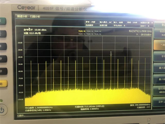

Hi Team,
I don't have an EVM board, and I am using a self-made board to debug the DAC38RF84, and now I have a strange problem. I use FPGA to generate a 64-point sine signal (I channel) and cosine (Q channel). Each sampling point is 16 bits, and I send it to DAC at the rate of 360M MPS for I and Q respectively. But the output of the DAC is a multi-frequency spectrum, not a single-frequency spectrum. The frequency spectrum appears periodically at the frequency of sine (5.625MHZ) as shown in the picture below. I am confused why there are so many frequencies?
I used CLK_P/N as the clock input with a frequency of 180MHz. LMFSHD = 82121, 16x Interpolation.K=32. SYSREF is set to 2.8125MHz, LANE RATE =1800MHZ, sampling frequency is 5760MHz, only NCO1 is used, the frequency of NCO1 is configured as 1.26GHZ, and 1 pair of IQ inputs. The PLL clock and SERPLL clock are also locked. The following is my register configuration table.

  • Katherine,
    I show no signs of these harmonics with my setup using your settings. Compare your register settings to the ones attached. What does your output look like if you use the DAC in NCO only mode and set the NCO to 1.266Gsps?
    Jim

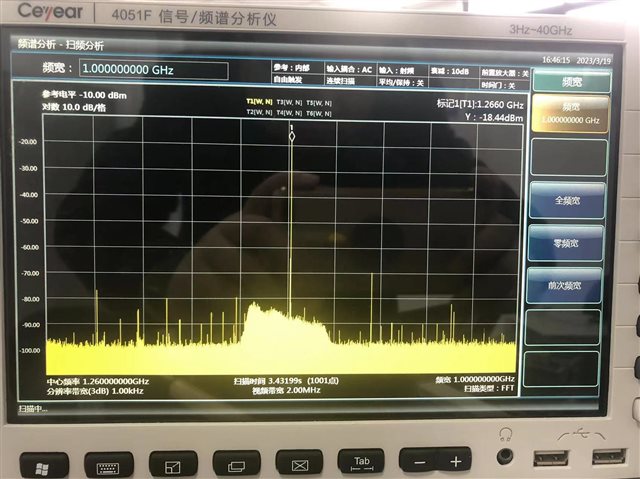

  • Jim,
    Did you try it in NCO-only mode? Does it show a 1.26G single-frequency signal? These harmonics emerged when the FPGA side was given data through JESD. If I do not input IQ data to the DAC, it is also a 1.26G single-frequency signal.
    This is the spectrum in 1.266GNCO-ONLY mode.

  • Does the reset occur after power and clocks are present to the DAC?
    Can you enable the CLKTXP/N output of the DAC, set the divider for this to 4, and observe the waveform with a scope using R259? This will verify the DAC is receiving a good clock.
    How does the NCO only mode output look when SYSREF is turned off? If it is a clean tone, your issue may be the sampling of SYSREF.
    It appears both SYSREF and DACCLK are driven using LVDS from the LMK. Is the LMK DCLK10 and SCLK10 configured for LVDS mode?
  • Hi Jim,
    My reset started as soon as the FPGA was powered up and also provided the clock for the DAC. But my reset occurred before the clock was provided for the DAC. Would this have any influence?
    The test about CLKTXP/N output can only be done after two days as the chassis needs to be disassembled.
    Under 1.2666NCO-ONLY mode, I turned off SYSREF and obtained the following signals as shown in the picture. This should be a normal phenomenon, but why do multi-frequency signals appear when I use JESD to transmit single-frequency signals?
