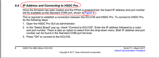

Hi :
I follow datasheet (User's Guide_kcu105), follow the instruction : 6.4 IP Address and Connecting to HSDC Pro.
but I don't know to see my KCU105 information about board IP and port.
should I key any instruction?
  • CIOU,
    Did you perform steps 5-8 in section 6.1? Did you do the steps in section 6.3 and set the FMC VADJ = 1.8V?
    Can you send a screen shot of your Standard Com Port Terminal?
    If you have done all of these steps with the ADC or DAC EVM board connected to the KCU105, try removing the board and repeating these steps.
