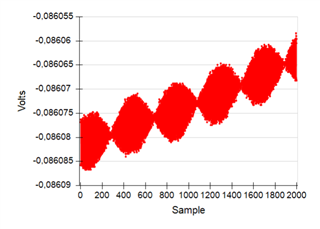

Dear Texas Instrument Team,
when doing the DC or AC measurement i see an oscillation in my signal (i guess it is crosstalk)
Ich exciting the DC and AC measurement with 5V and reading the signal with the AIN2/3 Pins.
The attached photo below shows that clearly.
BTW i am measuring two (but same) Wheatstone bridge at the same time and both are showing oscillation but with different frequencies.

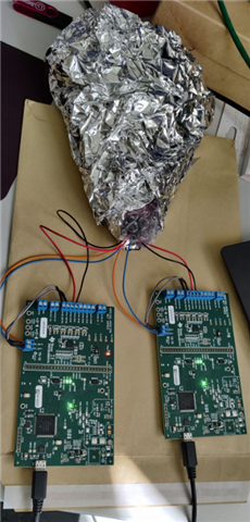

  • ich = "i" but in my case i wanted to write "i am" :D
    I have two ADS1261 (see picture below) and two Wheatstone bridges which are wrapped in bubblewrap and aluminum foil.
    For the DC measurement i use the internal reference and for the AC measurement the AIN0/1 external as REF.
    Marcel

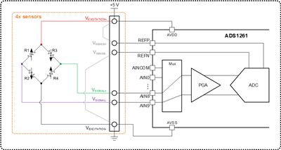

  • Hi Marcel,
    Thank you for providing more information. The following block diagram should be your connection for AC measurement with external 5V Vref as you said, please correct me if my understanding is wrong. Have you tried different data rate and filter options to check the result? I'm not sure if the local 5V power supply on the EVM is good enough as an excitation source for you bridge because all of power supplies on the EVM come from the USB port.
    The primary support engineer for this ADC is on vacation this week and he will come back next Monday, he may be able to do some tests for you if you can wait for him to come back.
    Dale
  • Dear Dale,
    the schematic you showed above is exactly my setup. I have used the AIN2/3 ports but that shouldn't make a difference, right?
    What else should i use for the the power supply?
    When doing the DC measurement i can see the point in not using the onboard power supply,
    but when doing the AC measurement with the 4-wire-AC-excitation, how else should i implement it.
    Isn't the board switching the polarity during the AC-excitation to make the measurement possible in the first place?
    Is there any way to lower the 5V output voltage? I wanna see if the oscillation decreases with less power = less crosstalk.
    Marcel

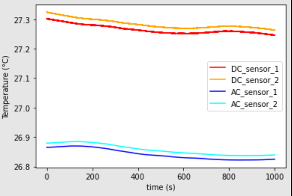

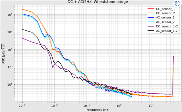

  • yes i am also seeing the oscillation when only measuring one bridge with DC.
    Like it wrote, the oscillation frequencies are changing over time (roughly 0.01 - 1 Hz) and are present in both bridges (one powered, the other one powered and both powered at the same time).
    Lets asume i can get rid of the osci, my next questions is:
    "Is the onboard AC-Excitation better (less noise) or should i use external switches like MOSFETS ?"
    For now i am only using the onboard ac-excitation and i can't see an improvement when comparing it with the DC-excitation.

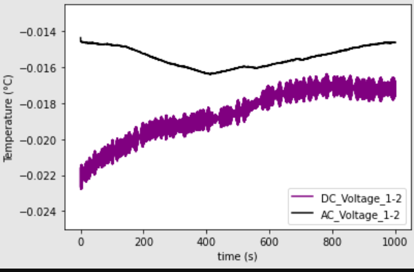

    The following plots are showing the results of both measurements. (ASD + time series)
    The data of sensor 1&2 where taken at the same time.
    The plot below in the left side shows the difference when substracting sensor1 one from sensor2 (time series).
    The sensors are wrapped in bubblewrap, aluminum foil and taped to the same aluminum plate.
    Marcel Beck
  • Hi Marcel Beck,
    If the AC excitation feature does not improve the system performance, then I would not use it
    The noise you are showing looks like 1/f noise, or temperature drift. If you are indeed taking measurements over 1000 seconds (16 minutes), then you might see this effect.
    If you measure a "noiseless" input source e.g. a 1.5V battery, do you see the same issue?
    -Bryan

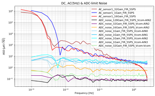

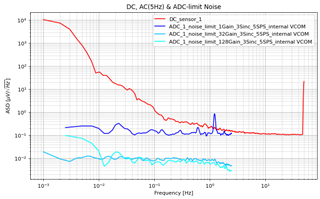

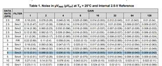

  • I tried to repeat the measurements from the table above. (5SPS, SIC3,...)
    My results (figure below) are showing pretty much the noise from the datasheet. The ADC Conversion  Data Code i used is:
    Code = Code * V_ref */ (Gain * 2^23 )      Is this the right way to convert  ?
    Is V_ref=5V or 2.5 V when REF: AVSS AVDD and INPMUX: VCOM  ?    I think it should be 5V since the difference of AVSS & AVDD is 5V but i could be wrong.
    Are the blue plots my noise limit before connecting the sensor?
    Marcel
  • Hi Marcel Beck,
    In the formula you are using, you have "code = code ...". I assume this is "code (in Volts) = code (in decimal) ..."
    VREF is 5V when REFP = AVDD and REFN = AVSS because VREF = REFP - REFN
    Correct, the blue plots are the noise of the ADC at the different "gain + data rate + filter type" combinations. If you externally short two terminals at the input of the PCB e.g. AIN0 and AIN1, then you would get the noise of the board including the signal conditioning circuitry, which in this case is really just the anti aliasing filters
    -Bryan

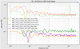

  • i still quite dont get what exactly is connected when doing the test from the datasheet (table).
    for my REF i use AVDD & AVSS    (=5V)
    for my IMPMUX is use MUXN: Vcom   &   MUXP: Vcom
    I measure noise at zero volt. Why am i not meauring noise at 2.5V sind the Vcom is (AVDD-AVSS) / 2   ?
    i get a factor of 2 less noise if i choose MUXN: Vcom   &   MUXP: AIN0      (or AIN1,2,3...) why is that so ?
    Another question is why do i get a drop down when getting close to the sampling rate/ (nyquist) only for Gain>1 ?
    The following measurements (only the ADC_noise_...) are taken with REF AVSS & AVDD while the INPMUX and the Gain is changed.
    Thanks in advance and best regards,
    Marcel Beck
  • Hi Marcel Beck,
    What do you have connected to AIN0, AIN1, etc.? I am not sure why the noise is different / better
    I don't see a drop down getting close to the sampling rate, except for those plots where you have the sensor connected. Also, please keep in mind that the ADS1261 is not a Nyquist converter, so it is sampling at a much higher rate than the data rate. This higher rate is called the modulator frequency (fMOD) and is approximately 1 MHz on the ADS1261
    How are you generating these noise density plots? I assumed you would just use the noise values provided the ADC GUI, especially since you are measuring a DC signal
    -Bryan
  • AIN0, AIN1 are connected to the sensor but with zero voltage supply (in theory you could also disconnect the sensor but in still wanted to check if any noise is coming from the sensor even though there is no voltage applied).
    I use the noise values proved by the ADC GUI. The data is afterwards converted in python with our linear spectral density.
    The plot below shows all of the measurements i mentioned above. The only difference is the INPMUX connection.
     The measurements for Vcom/Vcom are in good agreement with the data sheet (manual).
    Why are the measurements for the Vcom/AIN2 and the AIN2/AIN3 showing lower noise?
    Marcel
  • Hi Marcel Beck,
    What is connected to AIN2 and AIN3 then?
    I am not really sure why the other configurations are lower noise. If shorting both inputs to VCOM yielded datasheet-level noise, there is no real reason the noise should be less than the datasheet. The datasheet noise is really the lowest possible noise the ADC can provide, unless additional averaging is performed.
    Can you send me screenshots of the ADC GUI showing the noise results for each configuration? Also please let me know what reference voltage you are using and which gain, assuming it is not obvious from the screenshots.
    -Bryan
  • AIN2/AIN3 are still connected to the sensor but there is no voltage supplied, so basically there is "nothing" connected.
    My REF is the AVSS/AVDD
    All other configurations are the same only INPMUX is different.
    But since you are saying the data sheet values are the lowest noise possible i have a well measured noise-floor i can work with.
