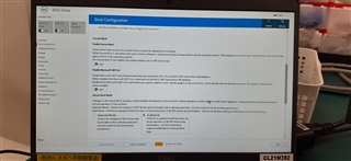

  • Hi Dale,
    I disabled the security boot.
    Please check this mode.
    I send you photo in boot.
    Tom
