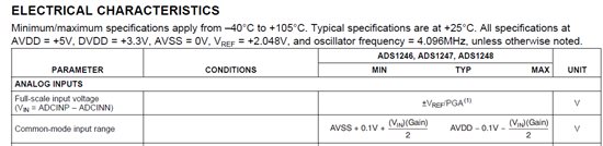

    regarding my situation as you know i have measured RTD three wire with ADS1248 used in differential mode, can i measure another input on the same ADS1248 with this specs:
    -single ended input {not differential} with signal from 0 up to 2Vdc.
    also can i use the same reference voltage that used with RTD measurements {2.5Vdc external}?
    Many thanks,
    Mahmoud
  • Mahmoud,
    There is a common mode input range restriction on the ADS1248, so you cannot measure single ended inputs if referenced to ground and AVSS is also connected to ground.
    Depending on what you are measuring, it may be possible to bias the input above ground into the valid range, or you might use an op amp to establish an offset into the common mode input range.
    As far as the reference is concerned, you could use the same reference, but remember that there can be noise added to your measurement.  The RTD measurement is ratiometric and the noise is canceled.  If you are only reading up to 2V difference between the inputs, then it may be better to switch to the internal reference to take that measurement.
