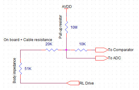

    With the feared limitation of AC lead-off detection, how good are the DC methods (current or pull-up.down) while acquisition is active? I remember this from somewhere that the DC methods cannot be used while acquisition is active. Please see the piece of schematic attached (derived from Application Report - SPRAB36A – July 2009 - ECG Implementation on the TMS320VC5505 DSP Medical Development Kit (MDK)).
    Due to continuous feedback, the RL drive establishes a potential of 0 (theoretically) at the point where the electrodes are placed. Since both comparator and ADC have relatively huge input impedance, the pull-up resistor and on-board resistance can be viewed as part of a voltage divider network. Hence when the electrode is connected, the voltage at the mid-point of these two resistors would be 5mV for AVDD=2.5V and given value for resistors. This falls well within the common mode as well as differential mode of the ADC. Now when the electrode is off, there is no particular current path except the infinitesimally small leakage currents, and close to full AVDD appears at both comparator and ADC inputs.
    Q: Is this theory true in case of ADS1298 with DC pull-up/down or current source methods of lead-off detection so as to use them while acquiring, or are these modes available only when the ADC is not acquiring?

    We have customers currently using AC or DC lead off methods to continuously determine which leads are off.  There are differences between the lead off detection of the discrete ADS1258 solution and the fully integrated solution found in the ADS1298.   Have you by chance gotten one of the ADS1298ECGFE-PDK setups and a simulator?   We'll try to put together a little tutorial explaining the process...
  • Tom,
    I haven't had a chance to get dirty with the PDK but I am making my own test board with help from PDK schematics. Should have the results in a couple of weeks. Currently my plan is to go ahead with current source mode for the better input impedance it gives. Since it doesn't require any external components to switch between the three modes, I am hoping to study in detail about all three using the same board.
