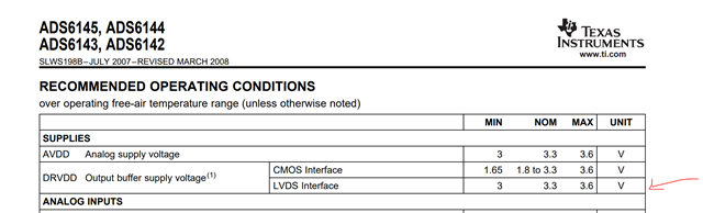

I plan to capture it in FPGA with 80Mbps sampling in switching to CMOS mode(DDR) mode.
We are considering switching to CMOS mode because there is a possibility that the timing will not keep up with DDR.
Should I change DRVDD from 3.3V to 2.5V when switching from LVDS mode to CMOS mode? Are there any other pins that need to be changed?
Eevee
  • Hi Eevee,
    No, please follow the recommended operating conditions of the datasheet.
    Rob
  • Hi, Rob
    Is it correct to understand that the decision between LVDS and CMOS is determined only by the DRVDD voltage?
    Also, is the decision made only when the power is turned on?
  • Eevee,
    If the part is set to use parallel interface mode, the voltage applied to the SEN pin will determine if the part comes up in CMOS mode or LVDS mode. See table 2 of the data sheet for more information regarding this.
    If the part is set up to use serial programing interface, the part will come up in CMOS mode (default value of "0" for bit D8 of register 0x00). To change this to LVDS mode, write a "1" to bit D8 of address 0x00.
