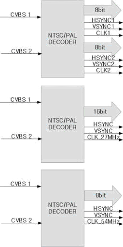

  • Thank you Jim,
    So How to compose it In order to receive below BT.656 format?
    Could you pls recommend for Line-interleave?
     Belpw
    Attached blocks is what I want to compose between DM368 and video decoder I/F.
    It's O.K to select anyone of them !!
    Pls guide one more time.
    thanks,
    Eric KIm
  • Hello Kim,
    Using the TVP5158 with the DM368, you can use a single 16-bit interface or a single 8-bit interface but not the dual 8-bit interface.
    Jim
