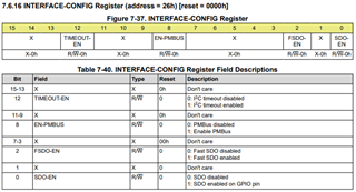

  • Many thanks, I am going to try using the status register, but first I am just enabling the SDO for 4 wire SPI interface.
    I've enabled it in the INTERFACE-CONFIG register by setting SDO-EN, but what is the FSDO-EN? I can't find any reference to FSDO-EN in the datasheet?
    Currently my circuit has a 10k pull-up on the MISO line (as recommended in the datasheet) but the actual level change on the pin is quite slow (you can see the charge curve), so I am looking to improve it. Is there a register setting that I should be changing, or do I just need to pull it up harder?
  • Hi Phil,
    1. for FSDO details, please check the section 6.16 timing diagram,  FSDO = 1 enables fast SDO out by half a clock cycle.
    2. regarding MISO slow rise, there is no setting to change the rise/fall of digital lines. You should need change the pull-up resistor.
