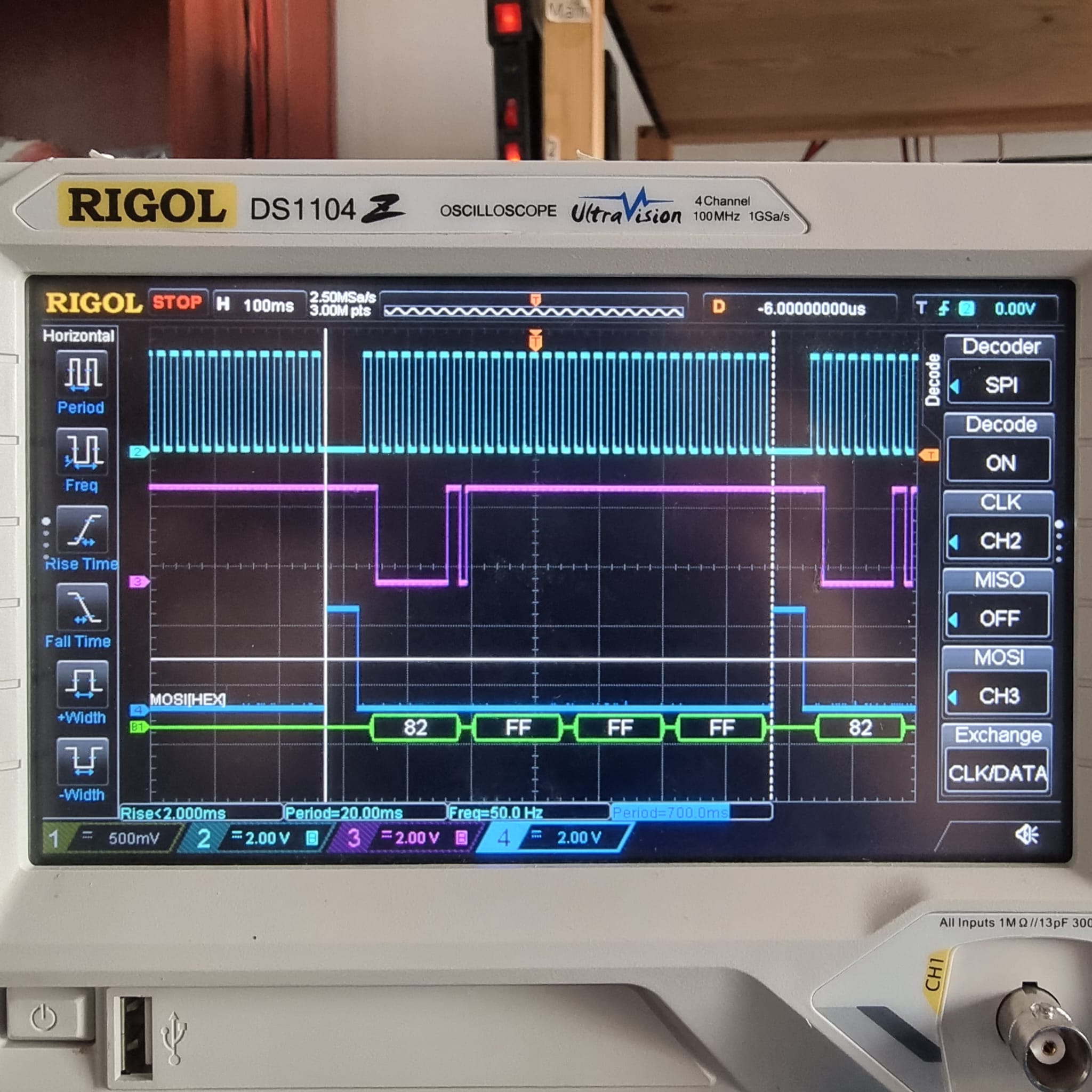

I'm doing a Bachelor Thesis on the control of a special device with a DAC so I wanted to first test the controlling of the DAC with my Arduino MKR Vidor 4000 board.
I have tested the SPI communication of the code with my Oscilloscope and everything seems to be in order but when I try to communicate with the DAC Evaluation Board it doesn.t work.

    I think we should start with the basics - how do you have the EVM connected? Can you sketch a diagram? Is the device fully powered?
    Next, I recommend you use an oscilloscope or logic analyzer to monitor the SPI interface while communicating - you need to confirm the format is correct, taking extra care to confirm that the phase and polarity is correct for the device.

    So the device is fully powered and I also already tried it with the BP-DAC11001EVM 1.0.0 software provided to test the EVM with the TI Launchpad.
    The EVM worked perfectly with the software which means that the EVM is able to communicate with other devices via SPI.
    I also made sure that the parameters of the SPI communication are good SPI_MODE1, polarity...
    Moreover, I tried this morning to manually create the SPI communication by setting myself the SPI CLK, the MOSI pin and the Source Selection or Chip Selection pin:
    On the picture the blue signal is the clock, the magenta one is the MOSI signal and the blue one is the CS.
    The data I am sending is 0x82FFFFFF because I wanne read the CONFIG_1 register of the DAC to make sure that the SPI communication is working.
    Do you see some issues or things I should try to improve my SPI communication and make sure that I'm able to get some response from the DAC.

    Your command looks correct, but keep in mind that you need after the read command, another 32 bit command must be sent (can be NOP or any other) in which the SDO pin clock out the data.  So in total, a read command needs two SPI packets.
    Can you ensure that your external controller is also grounded to the EVM? I see the digital lines are connected, but no dedicated ground.
  • Hello Paul,
    By making my SPI transmission only manual, simplifying my code a lot and grounding the pins of the EVM with the pin of my Arduino Board I managed to control the DAC with my Cpp programm.
    Thank you very much for your help !!!
