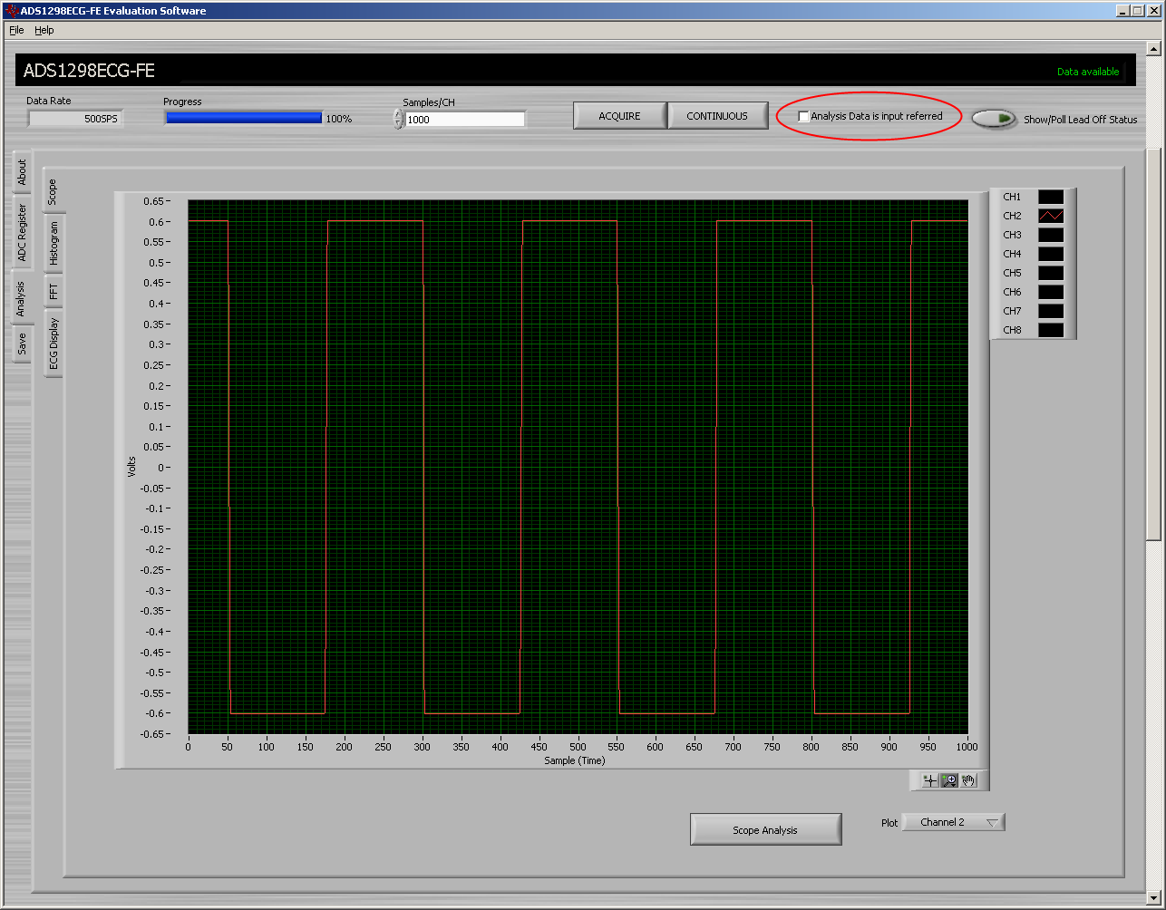

    The display on the ADS1298R software is always input referred so using a 200mV signal should display a 200mVamplitude in the scope tab regardless of your gain setting - the signal is actually being amplified inside the PGA on the ADS1298R, it's just being displayed on your PC with the gain factor take out.  If you would like to see the data without the gain factor correction, download and install the ADS1298ECGFE-PDK software.  This is essentially the same as the ADS1298R code with the respiration features removed.  The code will still run with the ADS1298RECGFE-PDK hardware so there are no issues there.
    One other difference is that the ADS1298ECGFE-PDK software has a check box at the top of the display that allows you to turn off the gain fator correction so you see the data at the output of the ADC.  I've attached a couple screen shots for you in a zip archive to show the differences.  Now, speaking of your square wave input, how do you have your generator connected to the EVM?
    8561.2HzSquareWave.zip

    In the screen shot I sent you, I used an Agilent 33522A generator with a BNC to ball clip cable on the right side of JP32.  You are correct in that JP31 goes to CH3, there should be no difference though.
    Are you running the ADS1298R with bipolar supplies?  If so, ground the IN(N) terminal to TP1 or TP11 and apply your signal (with no offset) to the IN(P) terminal and you should be able to get a clean signal displayed on the scope tab.  If you are running with 0-5V inputs, you'll need to offset your input signal and apply a DC voltage (Vref/2 for example) to the IN(N) side to stay within the common mode limits of the device.
