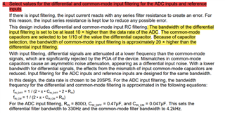

1. The ADS1261 ADC have data rate rang was 2.5 to 40KSPS, whether it is possible to perform filter calculation for the maximum limit of 40 ksps..?, if it is possible to calculate, then what should be the maximum limit for Cut off frequency of differential & common-mode to consider for the filter design?
2. I did the filter calculation for this adc with the data rate of 40ksps. Whether the below calculation can be considered for the thermocouple design?
here I consider 1 SPS = 1 Hz is it correct?
ADS1261 - sugession
Ref Tesk Value Unit Common mode cut off frequency Differential mode cut off frequency
C165 = CM1 0.000000004700 F Formula fIN_CM = 1 / (2 • π • CIN_CM • RIN) Formula fIN_DIFF = 1 / (2 • π • CIN_DIFF • 2 • RIN)
C167 = CM2 0.000000004700 F
R149 = RIN1 1130 Ω
R150 = RIN2 1130 Ω FIN_CM1 29982.23852 Hz
C166 = CDIF 0.000000047 F FIN_CM2 29982.23852 Hz FIN_DIFF 1499.111926 Hz
The above snip has been taken from this link for your reference: K-type thermocouple measurement circuit with precision ADC
