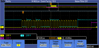

    I will upload a picture (if i can) of my oscilloscope to show you the signal I am sending it currently, as I have inspected the timing diagrams, but will check them again.
    Thank you for your responses.
  • Here is the signal I'm currently sending on repeat.
    Yellow: CLOCK
    Blue: DATA
    Purple: *CS
  • Hi Garth,
    THe 2.49V is a bit low for IOVDD. You should continue to apply the 3.3V IOVDD, especially if that's the voltage range you're using for SPI.
    The Ref Out pin being 0V means the chip might not be receiving power correctly. Could you measure the voltage on TP3 (AVDD/DVDD), TP4 (AVCC), and TP3 (IOVDD) to make sure they're being powered correctly? Also let me know how the jumpers are situated. If you're using the 24V supply, JP3 should be 1~2, JP4 should be 1~2, and JP5 can be any configuation. (1~2 if you're using the 24V, or 2~3 if you want to use a different external supply)
    Erin
