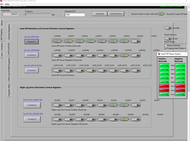

    I made the following test with ADS1298REVM. The registers are shown below.
    The RLD is set as (LA+RA+LL)/3. LOFFP/LOFFN and RLD_SENSP/RLD_SENSN are shown below.
    Question1.  When the LL lead is take off, the register shows that the LL and RA are both off. Can you help to solve this problem?
    Question2.  I find that when I set RLD=(LA+RA+LL+V1+V2+V3+V4+V5)/8. The above problem will be solved.
                         But that makes the waveform changes. What is the right RLD configuration?
When RLD=(LA+RA+LL)/3
When RLD=RLD=(LA+RA+LL+V1+V2+V3+V4+V5)/8
    Thank you.
Frank

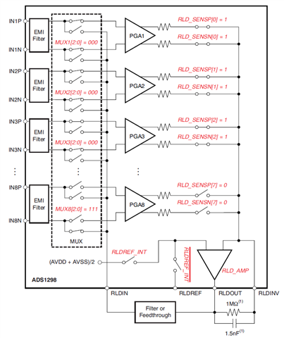

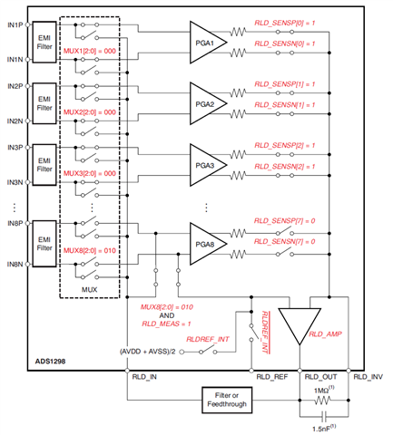

    1."We got RLD = (RA+LA+LL)/3. Isn't it?"
    It could be a simplified assumption/representation.
    You can refer to datasheet Figure 43. RLD Channel Selection. However, the block diagram is just showing the abstraction of the circuit, doesn't really represent the real exact implementation. RLDOUT also depends on the external feedback resistor across RLDOUT and RLDINV, and then follow the summing amplifier equation.

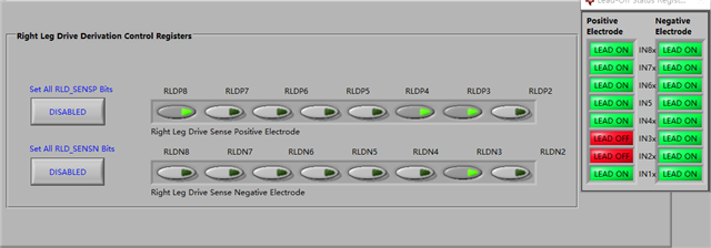

    Where&How do you identify RA electrode/pin in the GUI? I.e. which pin or pins does your RA electrode go into?
    Did you enable the LOFF_SENSP and/or LOFF_SENSN that is associated with your RA electrode?
    If not, try enable the LOFF_SENSP and/or LOFF_SENSN bits that are associated with your RA electrode, one at a time and monitor. e.g. try enable LOFFP1 and LOFFN1, one at a time and both.
    3. Thanks for clarifying. So, only RA is not responding correctly. So, Do you mean that RA is always reported as OFF?

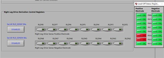

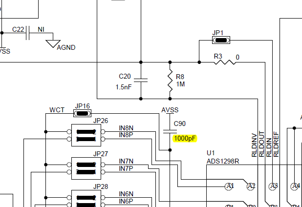

  • Hi ChienChun Yang,
          1. The ADS1298REVM board is used. The external circuit is with JP1 on.
         2. The configuration is show below. The board jumps are set as default.
             Only LL and LA are disconnected, while the Lead-Off Status tells IN3x and IN2x are disconnected, which indicates RA.
         3. No. Only when LL and LA are disconnected, it says LL/LA/RA are all disconnected, which is wrong.
            When LL is the only lead disconnected, it says LL is disconnected, which is right.
        Thank you.
    Frank

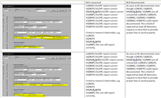

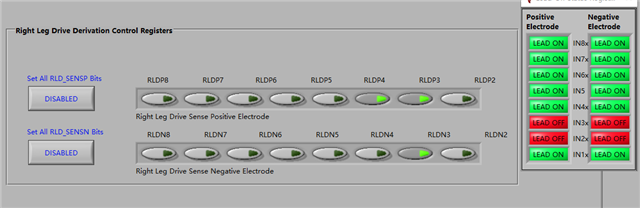

        I find that, RLD configuration has relationship with the issue. In the following experiments, LL and LA are disconnected.
        [CFG1]   RLD=LA+RA+LL/3
        [CFG2]   RLD=LA+RA+LL+V3/4
        [CFG3]   RLD=LA+RA+LL+V1/4
     [CFG4]   RLD=[]

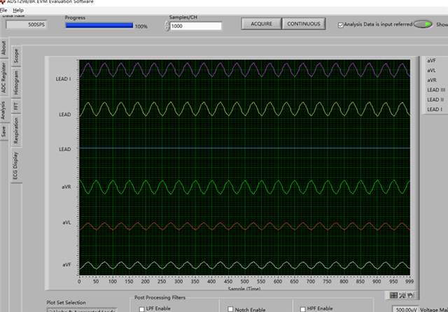

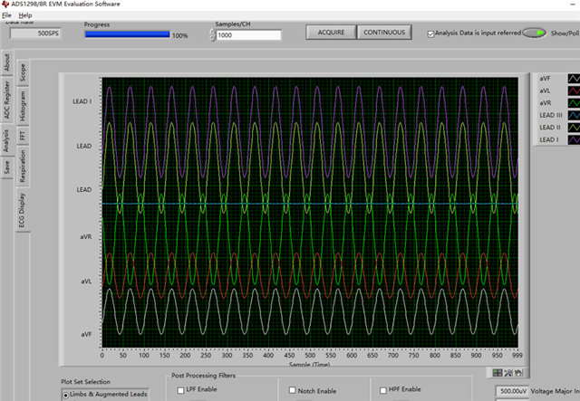

       But, with CFG2/CFG3/CFG4, the waveform will has distortion when the input has 300mV bias. Which I have discribed in
    ADS1298RECGFE-PDK: What is the best RLD_SENS conifiguration? - Data converters forum - Data converters - TI E2E support forums
      So, CFG1 is the only configuration I can use. But it tells RA wrong when LA and LL are disconnected.
      Is there any solution?
      Thank you.
    Frank

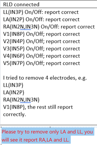

    With the RLD settings as EVM GUI's default, and make sure you connect the RLD electrode to the ECG simulator -
        My configuration is the same with the 1st configuration in your picture.
        And please note that in my post:
     1. When any one while only one lead is off (except RLD), LeadStatus is correct.
       2. When 2 of them are off, LeadStatus is correct except when LA and LL are both off.
           when LA and LL are both off, it tells RA/LA/LL are off.
       3. When 3-7 of them are off, LeadStatus is correct except when LA and LL are off.
           when LA and LL are both off, it tells RA/LA/LL are off. For example, when LA/LL/V1/V2 are off, it tells RA/LA/LL/V1/V2 are off.
        Please try to remove only LA and LL, you will see it report RA,LA and LL.
        Or if you remove LA\LL\V1, you will see it report RA\LA\LL\V1.
         Thank you.
    Frank

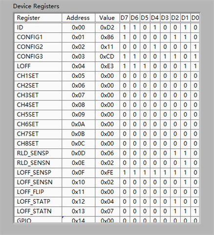

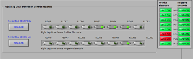

         Would you please give me all the registers data, so I can check the difference between my configuration and your configuration?
         And the most important registers related to this issue may be in this photo.
    Frank

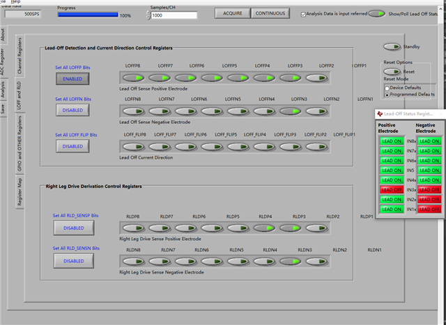

  • Try
    Turn on LOFFP1 and LOFFN1
    Turn off all RLD_SENSP and RLD_SENSP.
    Use an ECG simulator and make sure RLD electrode is attached firmly.
    Thanks.
        Turn off RLD_SENSP and RLD_SENSN will disable the RLD. Why "Turn off"?    Do you mean "Turn on"?
    Thank you.
  • No. They don't. Please study the data sheet.
    Thanks.
  • Hi Yang,
         I tried "Turn off all RLD_SENSP and RLD_SENSP.", it works!
         Now, the LeadOffStatus is right, in every lead off combination situation.
