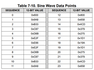

The datasheet for the DAC53204YBHR shows 12b codes for the sinewave generation function (page 42). Is there an equivalent for the 10b variant of this DAC family?
Thanks!

Hi John,
The codes will be the same, just shifted right to 10b.
For example, 0x200, 0x26A, 0x2CC, 0x321... so on.
