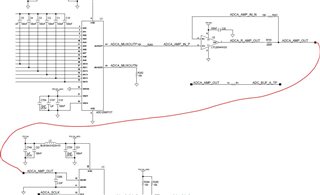

3. using the device in single ended mode, i thought connecting the MUXOUTN to 10K pulldown resistor and the MUXOUTP to unit gain buffer with serial 10K resistor in the positive input, and 10K resistor in the feedback (op amp LTC2054HV). the output of the opamp will be connected to the ADCINP, and the ADCINN will be connected to GND (cap 2.2nF between those inputs). can I use this configuration?
    Can you draw this configuration, instead of describing it? I would like to see what you intend to do.

    3. attached the schematic as you asked.
    Instead of using the system you have shown and grounding ADCINN, you could potentially tie AINCOM to a mid-supply voltage e.g. 2.5V. Then you would measure your single-ended signal on AINx (e.g. AIN9) with respect to this voltage, instead of ground. You could then buffer both MUXOUTP and MUXOUTN. This is called a pseudo differential measurement. It will allow you to use more of the ADC's code range because the ADC's code range is bipolar. Right now, with a single-ended signal and ADCINN grounded, you can only use half of the ADC's code range (0 to +FS)
