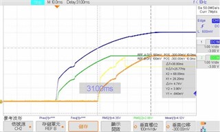

My customer production their product uses ADC8556 that fount some issues here. Could you give a suggestion here? thx
What situation will cause 5V output?  the fail rate is 10%.
Normal REF_IO is 2.5V waveform as below.
CH1=REF_IO CH2=REFen/WR(D3.3V)
Abnormal waveform as below.
