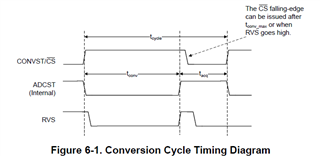

My customer is evaluating ADS8689, he found the conversion data of 1st cycle is incorrect, but the data of next cycles are correct, what could be the problem?

It's possible that either the power supplies have not fully ramped or the input signal has not settled after startup. Can the customer experiment with adding some delay before they begin ADC conversions?

Actually, the customer set ADDR 0x14 value to 0x0B (unipolar 1.25x Vref) and waited for long enough time to start the data conversion, but the 1st data did not show the new settings, the next data cycles were correct. Thus, we think it is not a problem caused by startup.

I believe it does make sense to discard the first ADC sample. Notice in Figure 6-1 that the conversion period occurs first, followed the acquisition of the next sample voltage. During the first conversion period, the sampled voltage is from the "previous acquisition," meaning whatever voltage was present on the internal sampling capacitors during startup is the value being converted. Once you convert this value, the next acquisition period will sample the proper input signal.
