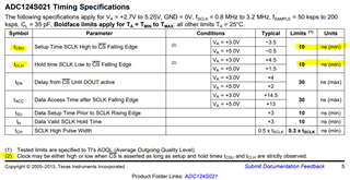

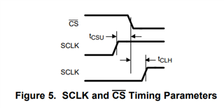

  • Hi Mike,
    There is no timeout feature on this device. If the SCLK edge is somehow missed between bursts, nCS would need to be toggled again. nCS may also need to be toggled at least once in the very beginning to ensure the tCSU and tCLH timing specifications are observed to ensure proper device function:
    Samiha
