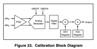

  1. After 4 gains if we used our readout jumping and my noise level also is high.
  2. Both (ADS1256 and ADS131M08) block diagrams are different means analog input > filter > gain format is followed in ADS1256 but in ADS131M08 analog input > gain > filter section is there. How we control the filter for effective results.

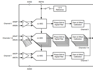

    Not sure what you mean by this, both have the same structure.
    ADS1256:
    ADS131M0x:

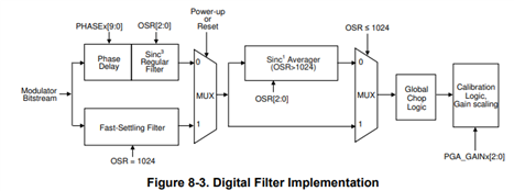

    The digital filter diagram shows that OSR, PHASE, and PGA_GAIN are the most important registers to change the digital filter behavior.

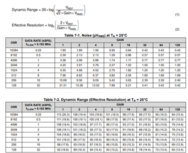

    How to avoid more gain use for sensor calibration.
    Noise and maximizing dynamic range (more gain to utilize more codes) are in opposition to another. Depending on bandwidth needs you could implement an external analog filter or front load the gain externally. You could implement a digital filter after receiving the data, such as a moving average (which is effectively another sinc filter). Most of this is external to the device.
    Really the only option to decrease noise is to increase OSR, which decreases your data rate and bandwidth capabilities.
