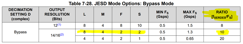

  • Hi Hidemi,
    In the ADC3xRF5x datasheets, we are trying to ease the lanerate calculations for users by providing a RATIO column in the JESD Mode Options tables. (see below example)
    For bypass LMFS=8422, the ratio is 10, so if sampling at 1.3GSPS, Fserdes = Fs * 10 = 13Gbps
    For decimation by 4 LMFS=8422, the ratio is 10 as well. But now, you have to incorporate the decimation factor into the equation as: Fserdes = Fs / D * 10 . So if sampling at 1.5GSPS now instead of 1.3GSPS, and decimating by 4, the equation is: Fserdes = 1.5GSPS / 4 * 10 = 3.75Gbps.
    Regards, Chase
